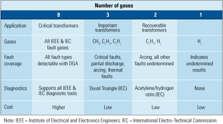

Early DGA systems were more art than science. They measured the concentration of hydrogen and/or one other combustible gas in transformer oil as a loose predictor of future transformer problems. Modern on-line DGA systems monitor up to 11 "fault gases," trend their concentrations and other transformer operating parameters in near real time, and come up with a suite of diagnostic tools.

Laboratory DGA has given way to portable DGA kits that save money and enable faster detection of malfunctions that could cause a transformer failure within days. Many utilities use both approaches to be safe rather than sorry. The business case for DGA is clear: Utilities have successfully used the technique to detect the imminent or eventual failure of hundreds of critical transformers. Each "save" has prevented the loss of thousands or millions of dollars in revenue—as well as the loss of public confidence that a blackout produces. The table compares the capabilities and costs of four different types of DGA systems.
Key attributes of on-line dissolved gas analyzers. Source: Serveron Corp.

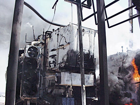

On July 4, 2004, Arizona Public Service (APS) found out what it’s like to have the media and public looking over its shoulder following the catastrophic failure of a huge, 1970s-vintage transformer at the Westwing Substation in northwest Phoenix that it co-owns with other western utilities.
Measurements at the Westwing Substation, a key transmission portal into the Valley of the Sun, gave no advance warning of an impending failure. The resulting fire (Figure 1) destroyed the transformer (a single-phase unit that steps down 525 kV to 230 kV) and caused much collateral damage.
1. July 4th fireworks. A transformer failure and fire at the Westwing Substation left Phoenix with razor-thin margins for a month during the summer of 2004. Courtesy: Serveron Corp.
Fortunately, APS was able to quickly locate a suitable replacement: a spare at Bonneville Power Administration. However, the 400,000-lb unit’s tedious journey from Washington to Arizona took 21 days, with each move covered by the media as Phoenix teetered close to rolling blackouts. Although Westwing was placed back in service on August 9, APS had to ask valley residents to curtail their electricity usage between 3 p.m. and 6 p.m. daily for more than a month.
An independent analysis concluded that the failure of the transformer, in bank T1 of the substation, was an "extraordinary event" not attributable to lack of maintenance. The immediate cause of the fire, said the report, was an internal fault that caused high pressure within the transformer, which breached the transformer casing (Figure 2).
2. Ready for recycling. The failed transformer’s load tap changing inspection door was partially ruptured. Source: Arizona Public Service
The failure, however, was actually the final event in a long chain of problems. On June 14, a fault on a 230-kV transmission line caused a grid disturbance that knocked all three units of Palo Verde Nuclear Generating Station off-line. The disturbance went undetected by a 30-year-old relay protecting the transmission line at Westwing, eventually causing a 20-second fault during restoration efforts that appears to have mechanically damaged the transformer’s windings. Weeks later, the wound progressed to an internal fault and fire, which destroyed five transformers: all three phases of transformer bank T1, a spare transformer, and Phase 3 of transformer bank T4 (Figure 3).
3. The lineup. When the smoke cleared, five transformers were found to be damaged. Source: Arizona Public Service
According to Steve Bischoff—general manager of construction, operations, and maintenance for APS—if an on-line DGA system had been on the job, it could have sensed the pending transformer failure due to the June 14 damage to the windings, and the July 4 fire may have been averted. Post-fault DGA and other testing, consistent with industry practice, did not indicate any problems with the transformer. The value of on-line DGA monitoring is being able to detect rapid changes in combustible gases, such as those seen in this case, which would not normally be detected through a manual sampling process.
