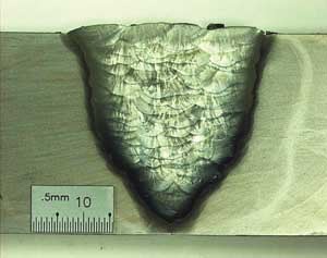

In the 1980s, research conducted by the Electric Power Research Institute (EPRI) and others indicated that a number of the issues associated with DMW failures are related to the composition of the welds’ filler metal — the metal added in the making of a joint during the welding process (Figure 1). Research also showed that conventional 309 stainless steel filler metal resulted in the shortest life and that nickel-based filler metals resulted in three to four times that life.
1. Filler metal. Cross section of filler metal weld. Courtesy: EPRI

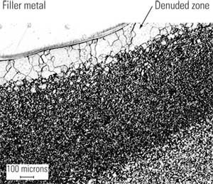

Research also showed that premature failures of DMWs are caused by a mechanism called carbon migration. One of the factors that give the Cr-Mo alloys their creep strength is that they form carbides by the combination of carbon and other elements, including chromium. When two materials with different levels of chromium are joined together, the carbon migrates during elevated temperature service from the lower-chromium-containing alloy to the higher-chromium alloy. As the temperature rises, the rate of carbon migration increases. This migration results in an area of depleted carbon, called a "carbon-denuded zone," in the lower-alloyed material and results in lower creep strength due to there being less carbon available to form carbides (Figure 2).
2. Carbon migration. In dissimilar metal welds using conventional filler metals, carbon can migrate, under increased temperature, from the low-alloy base metal to the high-alloy filler metal, creating a weak, carbon-denuded zone in the base metal next to the fusion line. Courtesy: EPRI
