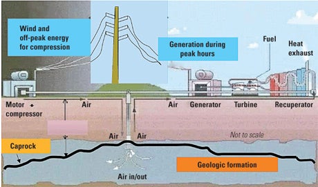

CAES plants work like big batteries. Electric motors drive compressors that compress air (at perhaps 1,100 psi) into an underground geologic formation during off-peak hours. When the electricity is needed most, the precompressed air (essentially replacing the compressor in a traditional combustion turbine) is used in modified combustion turbines to generate electricity (Figure 1). Natural gas or other fossil fuels are still required to run the turbines, but the process is more efficient—using up to 50% less natural gas than standard production, according to Sandia National Laboratories.
1. CAES in point. An artist’s rendering depicts how energy can be stored during off-peak hours as compressed air in underground geologic formations and be released during peak demand hours. Source: Sandia National Laboratories
