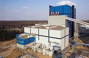

The world’s first supercritical circulating fluidized-bed (CFB) steam generator began successful operation at the Lagisza power plant in Poland early this July, according to power equipment and engineering firm Foster Wheeler. The new CFB — believed to be the world’s largest — replaced 1960s-era pulverized coal units at the power plant owned by Polish utility Poludniowy Koncern Energetyczny SA (PKE) (Figure 1).
1. Polish power. The world’s first supercritical circulating fluidized-bed (CFB) steam generator began operating this July at the Poludniowy Koncern Energetyczny’s Lagisza power plant in Poland. The project marks a milestone in the technology’s history. Courtesy: Foster Wheeler
