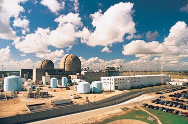

Deep in the heart of Texas, GE Energy’s nuclear business and South Texas Project Nuclear Operating Co. (STPNOC) announced that they have agreed to study the deployment and begin licensing activities for two GE advanced boiling water reactors (ABWRs) that would be located at South Texas Project Electric Generating Station (Figure 1).
  1. More of a good thing. South Texas Nuclear Project is looking to add two GE advanced boiling water reactors (ABWRs) to its 2,600-MW site in Bay City. Courtesy: South Texas Project
Other utilities considering building new nukes (such as Tennessee Valley Authority) have looked closely at the ABWR but selected either GE’s enhanced simplified boiling water reactor (ESBWR)—submitted to the U.S. Nuclear Regulatory Commission (NRC) for final design approval one year ago—Areva’s European pressurized water reactor (EPR), or Westinghouse Electric’s AP1000 design for fear they might be left with orphan units. Such fear now may be unfounded.
The two proposed reactors would be built adjacent to the two-unit, 2,600-MW plant that STPNOC operates in Bay City, Texas, about 90 miles southwest of Houston. The plant is owned by Austin Energy (16%), CPS Energy (40%), and NRG Texas LLC (44% ownership).

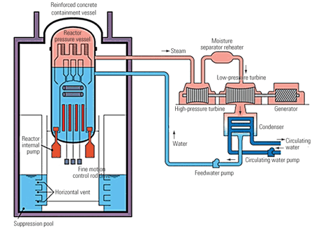

  2. Certified design. The ABWR design uses modern digital controls and places the recirculation pumps inside the containment vessel. Source: Tokyo Electric Power Co.
GE’s ABWR is the only proven Generation III reactor operating in the world today. Four units are currently running in Japan; the first started up in 1995 (Figure 3). Two more ABWRs are nearing completion in Taiwan, and construction has begun on a seventh unit in Japan. Additional ABWRs are in the planning stages. The four Japanese units’ "baseline" construction and operational data allow utilities considering ABWR technology to be more certain about project costs and payback periods.

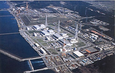

3. Generation III design. The 8,200-MW Kashiwazaki Kariwa facility in Niigata Prefecture, Japan, is powered by five 1,100-MW boiling water reactors (BWRs) and two 1,350-MW advanced BWRs. Courtesy: Tokyo Electric Power Co.
