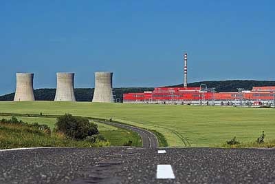

Also in November, Slovakia inaugurated construction of two new reactors at its existing Mochovce facility that would cover 22% of the nation’s power needs after completion in 2012 and 2013 (Figure 4). The €2.8 billion project continues work begun in 1986. Slovak government officials said the 880 MW of new capacity was necessary after terms in the country’s accession agreement with the EU forced the closure of two 400-MW Soviet-built reactors.
4. Slovak power. Slovakia inaugurated construction of two new reactors at its existing Mochovce facility, shown here. The new reactors are expected to cover 22% of the nation’s power needs after completion in 2012 and 2013. The new capacity is urgently needed after an EU accession agreement forced closure of two Soviet-built reactors. The country hinted it would restart one of those reactors this January, when it declared a state of emergency after Russia’s Gazprom disabled natural gas supplies to Europe. Courtesy: Slovenské Electrárne
