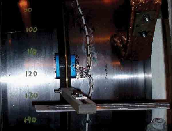

The first three vibration levels are typically measured by either displacement, velocity (the speed of the motion), or acceleration. Torsional modes describe the twisting and untwisting of the power train shaft and are the most difficult vibration problem for which to identify the vibration’s source and solution (Figure 1).
1. Twist equal to strain. The typical method of measuring torsional vibration in a power train shaft is to use strain gauges. Courtesy: GE Energy
