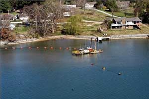

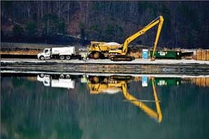

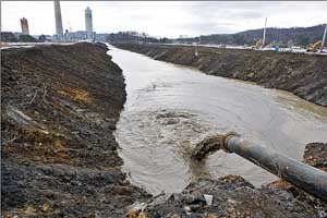

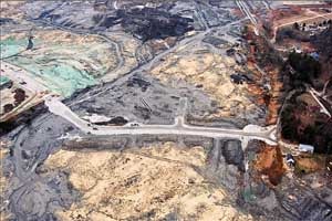

However, the December 2008 massive release of coal ash from Tennessee Valley Authority’s (TVA) facility in Kingston, Tenn., promises to move the federal government into a more active role in the management of coal ash. The TVA spill created national headlines and drew the attention of the public and elected officials to utilities’ current management practices related to coal ash. The breach in the TVA coal ash surface impoundment flooded more than 300 acres of land, damaging homes and property. Coal ash from the release flowed into the Emory and Clinch Rivers, filling large areas of the rivers and killing fish. TVA cost estimates for the clean-up range between $525 million and $825 million, which does not include long-term cleanup costs (Figures 1 to 4).
1. Moving ash. Aerial view of a barge with hydraulic dredging equipment removing ash from the navigation channel of the Emory River. Dredging operations began March 20. Courtesy: TVA
2. Collecting ash. Dike No. 2 construction was nearly complete when this photo was taken in late March. Courtesy: TVA
3. Storing ash. TVA constructed ash removal dikes and temporary ash storage facilities in February to contain the ash collected during clean-up operations. Courtesy: TVA
4. Hauling ash. Ash removal continues at theTVA Kingston Plant. Courtesy: TVA
