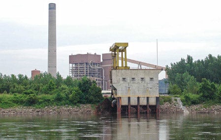

1. Down by the river. The Nearman Creek Power Station’s cooling water intake structure is located on the shoreline of the Missouri River. Courtesy: Kansas City, Kansas, Board of Public Utilities

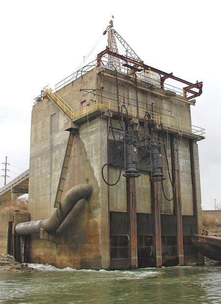

2. Powering up Kansas. A close-up of the Quindaro Power Station’s cooling water intake structure on the Missouri River. Courtesy: Kansas City, Kansas, Board of Public Utilities
