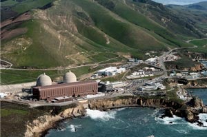

Diablo Canyon Power Plant, which is situated in a postcard-perfect location on the central California coastline, generates electricity for more than three million households in central and northern California. In 2009 the project team at the dual-unit Westinghouse pressurized water reactor facility replaced four steam generators at Unit 1 in just 58 days. Through meticulous planning and excellent project execution, performance on this Unit 1 project was an improvement on the earlier Unit 2 steam generator replacement project.
Located on the dramatic Pacific coastline and encircled by green mountain ranges, Pacific Gas & Electric Co.’s (PG&E’s) Diablo Canyon Power Plant (DCPP) has a surrounding worthy of a five-star resort (Figure 1). But the project team at this facility definitely did not embrace a laid-back California attitude during their recent steam generator replacement project (SGRP). Instead, they set up an aggressive work schedule and replaced four steam generators in Unit 1 in record time with a superlative safety record.
1.    Pacific powerhouse. The 2,300-MW Diablo Canyon Power Plant is located near Avila Beach in central California. The installation of eight generators in 2008 and 2009 was the largest project in the history of the plant since initial construction was completed in the 1980s. Courtesy: PG&E
