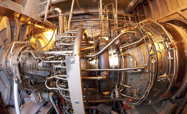

One of the keys to the excellent part-load efficiency of the LMS100 is its intercooler. It increases the turbine’s efficiency by precooling the air supply for the high-pressure compressor, thereby decreasing its power needs (Figure 1).
1. All in the family. The LMS100 low-pressure compressor has exactly the same parts as the first six sections of the heavy-duty low-pressure compressor in the MS6001FA power generation workhorse. But the technologies used in its supercore—the high-pressure compressor, combustor, and high-pressure turbine shown in this photo—first proved themselves in GE’s LM aeroderivative products, which are descended from the CF6-class aircraft engine. Also, the engine’s two-stage intermediate-pressure turbine and five-stage power turbine are based on the latest GE aeroderivative technology, and the latter was designed specifically for the LMS100. The external intercooler placed between the high-pressure and low-pressure compressor helps improve part-load efficiency: Even at 50% turndown, the LMS100 is nearly 40% efficient. Courtesy: Kiewit
