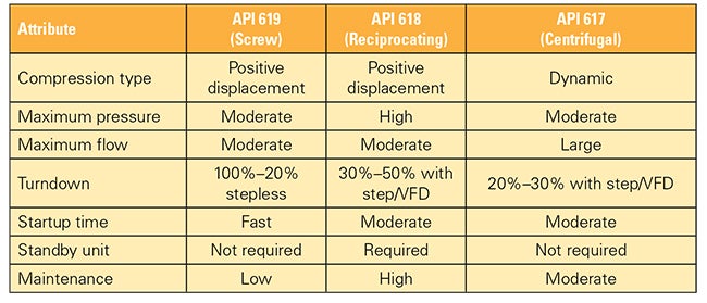

Comparative Summary
Choosing the right fuel gas compressor is not unlike choosing companions for a long journey (Table 1). Pick the wrong one, and the road becomes hard. Pick well, and things move with ease.
Table 1. Choosing the best compressor for an application requires considering several attributes. Note: VFD = variable frequency drive. Source: Kobelco Compressors America Inc.

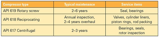

Maintenance and lifecycle differences are also important to consider when selecting the best compressor for an application. Compressor reliability is essential to avoid forced outages and maintenance profiles also differ significantly (Table 2).
Table 2. Typical maintenance requirements and common service items are noted for the three compressor types. Source: Kobelco Compressors America Inc.
While major maintenance should not be needed as often, the standard daily and weekly upkeep necessary to maintain a reciprocating compressor is steep. Major overhauls will also have a longer schedule and require more labor when compared against the other compressor types.
Centrifugal compressors don’t tend to require the same upkeep as a reciprocating compressor, but surge can impact its maintenance needs significantly. Surge is one of the most damaging operating conditions for centrifugal machines.
As previously alluded to, when flow drops below the stable limit, momentary flow reversal and violent pressure oscillations can occur, leading to severe vibration, mechanical fatigue, and ultimately premature wear or failure of critical components, including bearings, seals, and impellers. Even brief or infrequent surge events can significantly reduce the expected maintenance interval and increase lifecycle costs.
To ensure long-term reliability, centrifugal compressors must be operated above their surge threshold, with proper sizing, surge margin, and effective anti-surge controls in place. Plants with highly variable load profiles or frequent cycling should carefully evaluate these factors, as surge-related maintenance is one of the key risks when applying centrifugal compressors for a flexible power generation service.
Overall, oil-injected screw compressors tend to offer the lowest total maintenance cost and shortest downtime, making them attractive for flexible, frequently cycled power plants.

API 619 screw compressors—offering moderate discharge pressure (as high as 1,500 psig) and 100% to 20% stepless turndown—are increasingly popular due to their simplicity, flexibility, and resilience under punishing conditions. API 618 reciprocating compressors remain relevant for specialty high-pressure applications. API 617 centrifugal compressors are well-suited to baseload projects where stable, large flow is likely.
