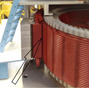

An air gap is the distance between the rotor and stator of a large-scale hydroelectric generator. This gap is a very small distance in relation to the size of the rotor. Its measurement to tight tolerances is critical to prevent damage to and maintain efficiency of the generator. Static measurement of the air gap (Figure 1) is required during initial installation, periodic maintenance checks, and again at reassembly of the generator following major maintenance operations.
1. This image shows a cut-away view of a representative generator model. The arrow points to the air gap between the rectangular stator winding on the left and the rotor on the right. This gap is typically measured at individual poles from above and again from the underside. Courtesy: Kaman Measuring

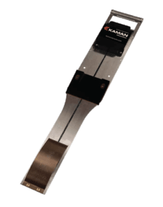

Kaman has developed a portable measurement device that helps reduce downtime by providing a fast, repeatable, and reliable means of measuring the static air gap in hydrogenerators. Kaman’s new static air gap tool (AGT) takes this static measurement electronically simply by sliding the spring end of the robust measurement paddle into the gap between the rotor and stator (Figure 2). Compression of the springs to match the gap is measured in real time by an eddy current sensor coil located between the springs. The compression springs are wide enough to account for variability in different rotor and stator windings. This permits the tool to be used with different winding sizes and patterns without adjustment.

Signal conditioning electronics at the handle end of the paddle accurately translate the inductance change in the sensor coil to distance —available in imperial or metric units—and wirelessly transmit to the operator’s handheld device. The AGT (Figure 3) is user-friendly and accurate. Like the parallels, the AGT can be used in any orientation, horizontally or vertically, depending on the design of the generator. The AGT is powered by a long-life rechargeable battery permitting up to eight hours of operation between charges.
3. The compression springs are located at the bottom of the device shown here, while signal conditioning electronics are at the top. It is equipped with adjustable wedges in the middle to provide a consistent insertion depth if the rotor and stator design permit. They are easily removed or adjusted by the user depending on the depth required. Courtesy: Kaman Measuring

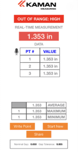

During typical use, operator A positions the tool between the rotor and stator poles. Operator B then records data via the mobile app. This can be done either by voice command or touching the “Write Point” button on the mobile device display (Figure 4). The app then sequentially numbers the data points and stores them, leaving no need for an operator to record manually. Data can be viewed in the app and downloaded to a personal computer for storage and analysis. This download feature is a major time saver for operators and eliminates possible manual data entry errors.
4. The mobile app intuitively stores measurements and notifies if out of range. Courtesy: Kaman Measuring
When the mobile app is launched, it will automatically search for an AGT within Bluetooth range, which is typically 10 ft. to 15 ft. An AGT within range will display on the screen and connect upon operator command. The intuitive user interface is easily set up prior to taking measurements. Main features include:
  • Entry of the installation or generator number.
  • Entry of high and low display limits of acceptable gap measurements.

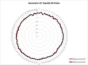

Recent testing at a large-scale U.S. hydroelectric generating facility reported reduced measurement time over previously used parallels. Measurements with the parallels required two hours to check every third pole, whereas measurements with the AGT required only 30 minutes to take measurements of every pole. Since data was required for both above and below the rotor, the AGT was able to realize a time savings of three hours.
At this same facility, the operator quickly downloaded data from the app into an Excel spreadsheet and generated a radar plot (Figure 5). The data is displayed with the actual pole number. Two sets of data were taken by two different operators to verify repeatability of the measurements. As can be readily seen, results are consistent. A quick review of the data can reveal inconsistencies or potential problem locations that should be verified.
5. Measurement data is easily and quickly reported for operator analysis. Courtesy: Kaman Measuring
