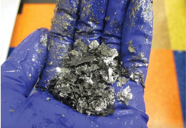

Large rotating systems in power plants—gas and steam turbines, generator bearings, hydraulic governors, and high-pressure pumps—depend on lubrication regimes that maintain film integrity, limit particulate intrusion, and manage thermal loads. However, these systems are continuously exposed to operational and environmental stressors. Even minor deviations in temperature, load, or contamination levels can initiate wear processes that steadily generate metallic and non-metallic debris (Figure 1).
1. This photo shows debris that is typically caught in a filter and subsequently analyzed. Courtesy: Eurofins TestOil

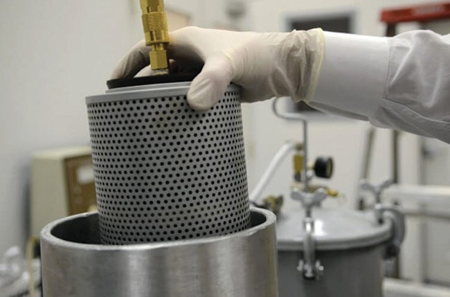

When particle count appears stable, FDA detects hidden wear. As mentioned, filters often trap the most severe wear debris before it reaches circulation (Figure 2). In fact, FDA uncovers this material even when oil samples appear nominal.
2. A filter containing debris is prepared for analysis in the lab. Courtesy: Eurofins TestOil
