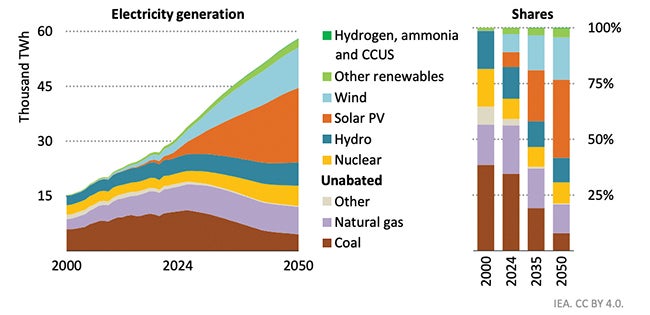

1. Global electricity generation by source in the International Energy Agency’s (IEA’s) Stated Policies Scenario (STEPS) to 2050. The electricity mix shifts steadily away from fossil fuels toward solar photovoltaic (PV) and wind, with renewables surpassing fossil generation by 2035 and continuing to expand through 2050, while nuclear maintains a stable contribution across the period. Source: IEA, World Energy Outlook 2025
3. Reshaping the Electricity Mix—All Fuels in Transition. The global power-generation mix is undergoing a rapid structural shift across all fuel types. Under the IEA’s STEPS (Figure 1), the share of fossil fuels in electricity is slated to fall from about 60% in 2024 to below 40% by 2035, and to just 20% by mid-century. Renewables, now roughly one-third of global generation, surpass 50% by 2035 and exceed two-thirds by 2050, driven primarily by wind and solar, whose combined share rises from 15% today to 40% by 2035 and 55% by 2050.
