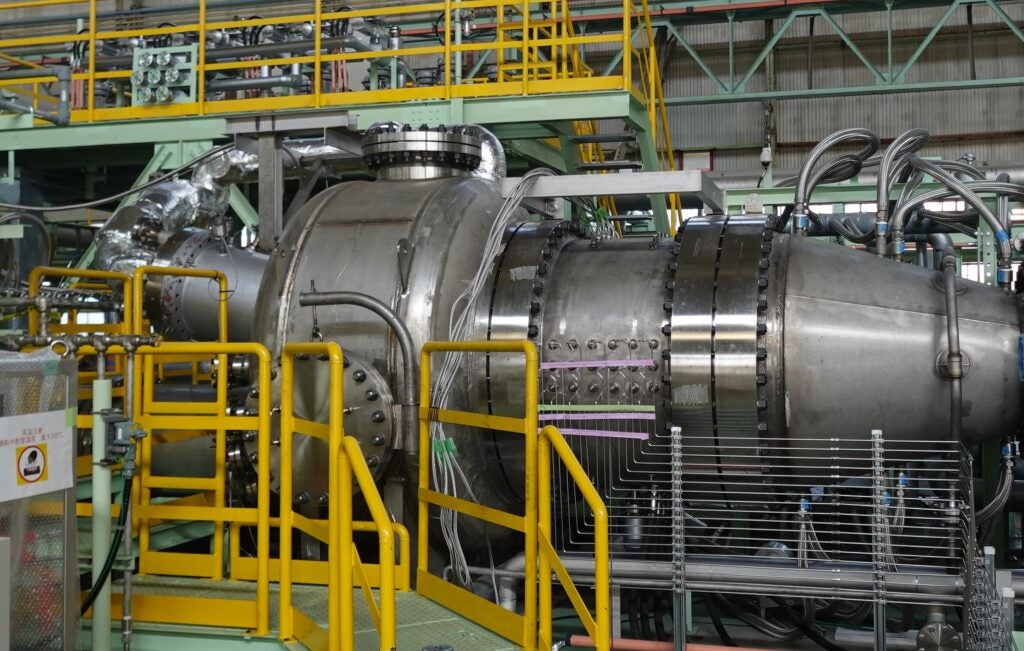

The test was conducted at IHI’s Large-Scale Combustion Test facility at Aioi Works in Hyogo, Japan, a purpose-built installation the companies inaugurated in June 2025 specifically to replicate GE Vernova’s F-class full-load operating conditions, including pressure, temperature, and air and fuel flow rates. The companies on March 17 said measured emission levels align with their joint development roadmap, which envisions the commercial deployment of an ammonia-capable F-class turbine by 2030.

The full-scale combustor test stand at IHI's Aioi Works facility in Hyogo, Japan, is engineered to replicate GE Vernova F-class gas turbine operating conditions, including pressure, temperature, and air and fuel flow rates. IHI and GE Vernova used the stand to demonstrate 100% ammonia combustion, as announced on March 17, 2026. Courtesy: IHI/GE Vernova
The full-scale combustor test stand at IHI’s Aioi Works facility in Hyogo, Japan, is engineered to replicate GE Vernova F-class gas turbine operating conditions, including pressure, temperature, and air and fuel flow rates. IHI and GE Vernova used the stand to demonstrate 100% ammonia combustion, as announced on March 17, 2026. Courtesy: IHI/GE Vernova
