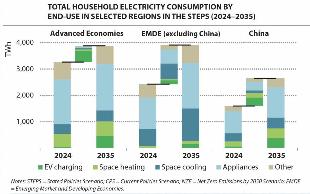

Household Electricity Use Could Climb Sharply as Electrification Expands
Household electricity use is rising worldwide as electrification expands across end uses. In the International Energy Agency’s (IEA’s) Stated Policies Scenario (STEPS)—which reflects today’s stated policy commitments—global average household electricity consumption could increase by about 25% by 2035. Growth is driven primarily by rising use of air conditioning, household appliances, electric vehicle (EV) charging, and electric space heating.
In advanced economies, household electricity demand could rise by roughly 15% by 2035 after years of stagnation, largely due to transport electrification. In emerging market and developing economies (EMDEs), demand growth is even faster—around 30% by 2035—as rising incomes and higher temperatures push cooling demand sharply upward.

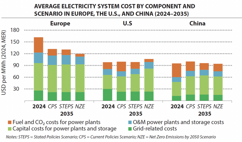

Electricity System Costs Are Shifting Toward Upfront Investment
Electricity systems are undergoing a structural shift in how costs are distributed. Fuel and operating expenses are expected to make up a declining share of total system costs, while upfront capital investment in clean generation, transmission and distribution grids, and energy storage becomes increasingly dominant across scenarios.
Expanding renewable capacity, rapid battery deployment, and higher grid spending all contribute to rising capital intensity. At the same time, supply-chain constraints and carbon pricing could add cost pressure in some markets. However, declining natural gas prices, a more diversified generation mix, and rising electricity demand could moderate averag
