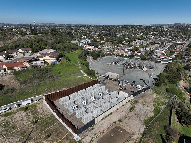

San Diego Gas & Electric in California offers a utility-based example. The group launched four microgrids (Figure 2) in its service territory to enhance grid reliability and support resiliency. Energy storage is an important piece of the microgrids, which serve schools, fire stations, and other enterprises across four communities.
2. The Paradise microgrid in California is one of four such installations built by San Diego Gas & Electric (SDG&E) to support grid reliability in the utility’s service territory. It is a self-contained energy system with battery storage that can operate independently from the larger regional grid. Courtesy: SDG&E
