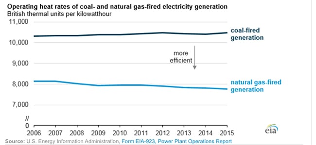

Between 2006 and 2015, annual average heat rates from the nation’s natural gas–fired power plants plunged 7%, while only decreasing 1% for coal plants, the Energy Information Administration (EIA) revealed on August 21.
Heat rates, which are measured in British thermal units per kilowatt-hour (Btu/kWh), refers to energy conversion efficiency, calculated based on the amount of energy used by a power generator to produce a unit of electricity that is supplied to the grid. Net generation accounts for all power consumed by the plant to operate the generators and other equipment, such as a fuel feeding systems, boiler water pumps, cooling equipment, and pollution control devices.
Lower heat rates generally indicate more efficient generation, because less fuel is needed to produce a kilowatt.  (For more about heat rates, boiler efficiency, turbine efficiency, and electrical efficiency, see POWER’s 2015 feature “Understanding Coal Power Plant Heat Rate and Efficiency”).
The EIA, which collects heat rate data from the nation’s fossil fuel–fired and nuclear power plants, said that the heat rate for all natural gas–fired generation averaged 8,471 Btu/kWh in 2006, which was about 18% less than the average heat rate of 10,351 Btu/kWh for coal-fired generation.
By 2015, the average heat rate for natural gas–generation (7,878 Btu/kWh) was about 25% lower than the average heat rate for coal generators, which had gone up to 10,495 Btu/kWh.
Meanwhile, the data shows heat rates for nuclear plants remained relatively stable during the period, increasing only slightly from 10,436 Btu/kWh in 2006 to 10,458 BTU/kWh in 2015.
Operating heat rates of coal- and natural gas–fired electricity generation. Source: EIA
