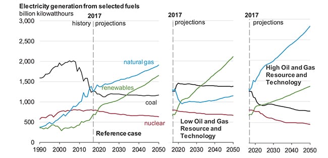

Natural gas generation, specifically, is expected to thrive, especially after the scheduled expiration of renewable tax credits in the mid-2020s, the EIA said. Natural gas’s share dominates in the reference case, but it especially soars in the high oil and gas resource and technology case.
But despite dim industry projections for coal-fired generation in recent years owing to regulatory impacts, the EIA’s reference case projects that in the longer term, the relatively low cost of coal will moderate a decline in coal-fired generation. Specifically, coal capacity will fall by 65 GW between 2017 and 2030 but level off near 190 GW through 2050, the AEO2018 projects. High gas prices could slow the pace of coal retirements, but retirements are likely to increase if gas prices fall lower, such as in the high oil and gas case.

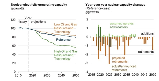

Cheap Gas will Prompt a Fifth of Nuclear Capacity to Retire

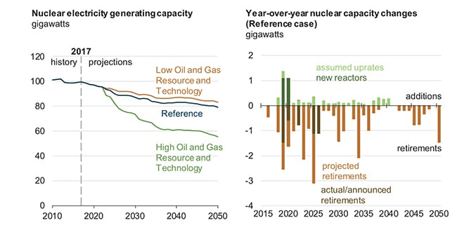

Notably, if natural gas prices fall, as is expected, 20% of current nuclear capacity could be retired. The reference case projects a steady decline in nuclear capacity—from 99 GW in 2017 to 79 GW in 2050—with no new plant additions beyond 2020. The reference case factors in completion of Vogtle Units 3 and 4—the only new nuclear units under construction in the U.S.—in 2019 and 2020, respectively, although Bechtel, which assumed responsibility to complete the project in August, suggests construction should wrap up in approximately 2022.
Nuclear retirements will mount if cheap gas continues, says EIA in AEO2018

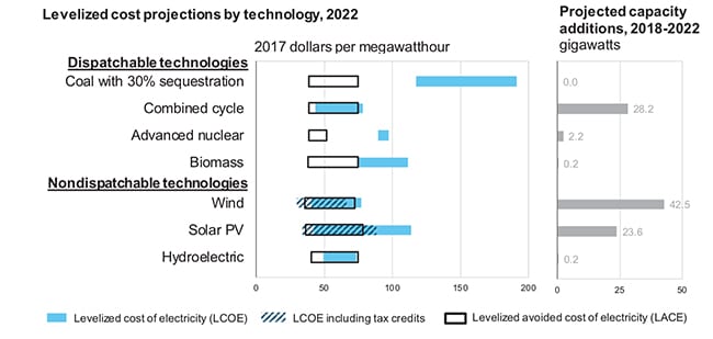

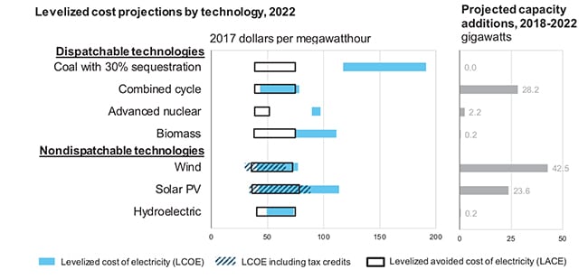

To assess which technologies will have the most favorable cost characteristics, the AEO2018 notably uses “levelized avoided cost of electricity” (LACE), a measure of what it would cost to generate the power that is otherwise displaced by a new generation project, along with “levelized cost of electricity,” (LCOE). LCOE, the agency said, “can be misleading because different technologies serve different market segments.”
Assuming that an overlap in LCOE and LACE indicates favorable economics for new builds in a particular technology, the EIA concluded that combined cycle, wind, and solar PV will have the more cost-favorable characteristics.

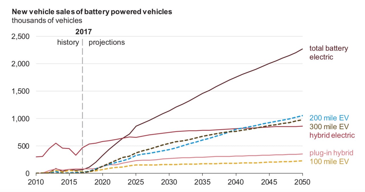

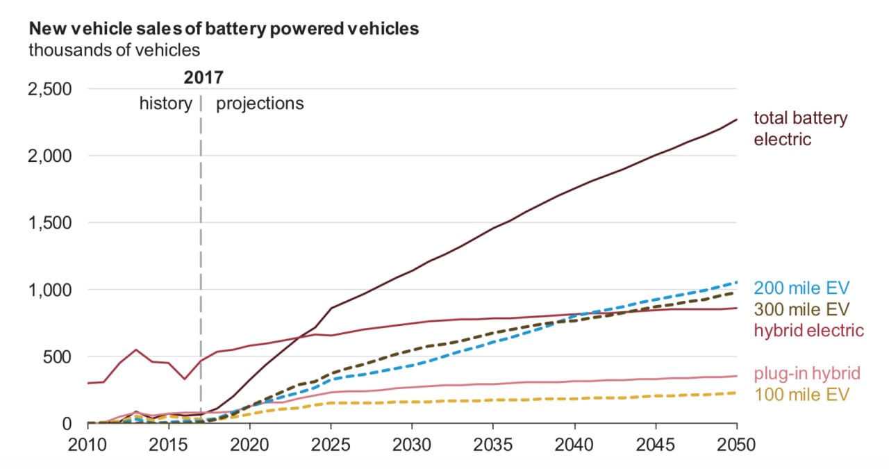

Another significant trend outlined in the AEO2018 relates to soaring growth of battery-powered vehicles. Battery-electric vehicle (BEV) sales will increase from less than 1% of total U.S. vehicle sales in 2017 to 12% in 2050, the EIA said. Plug-in hybrid electric vehicle (PHEV) sales increase from less than 1% to 2% over the same period. This development will spur a sharp increase in electricity use in the transportation sector, it noted.

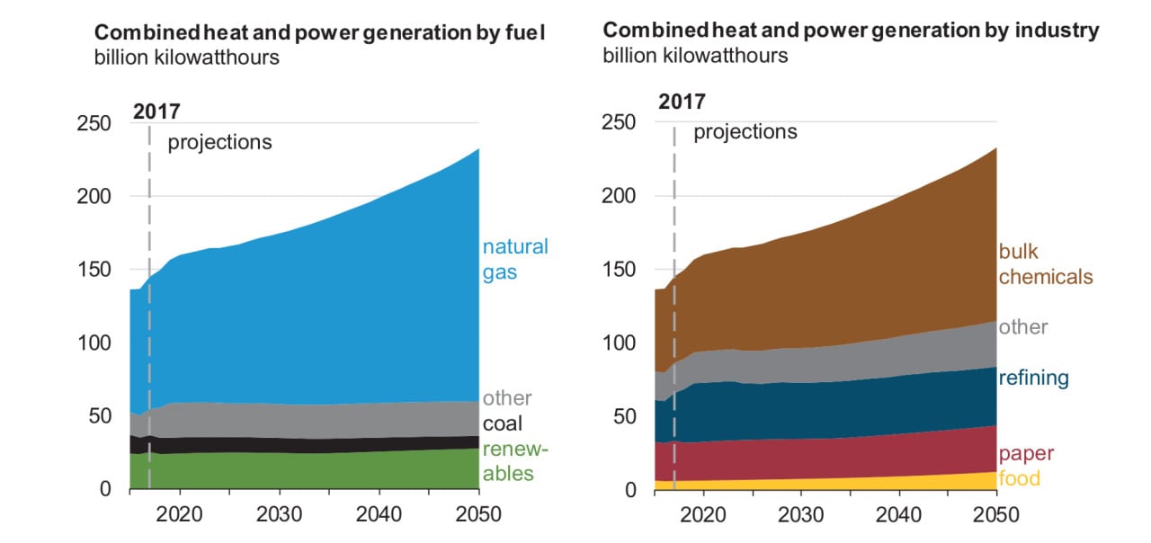

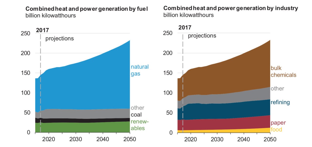

EIA_AEO2018_EVsHowever, efficiency gains and increases in distributed generation are expected to moderate total delivered electricity purchased from the electric grid, it said. Notably, power generated by industrial CHP technologies is expected to grow through 2050. Mostly fueled by natural gas, electricity consumption associated with CHP production in the industrial sectors grows from 0.5 quadrillion Btu in 2017 (more than 10% of total industrial electricity consumption) to 0.8 quadrillion Btu by 2050 (about 15% of total industrial electricity consumption) in the reference case.
EIA_AEO2018_CHP
