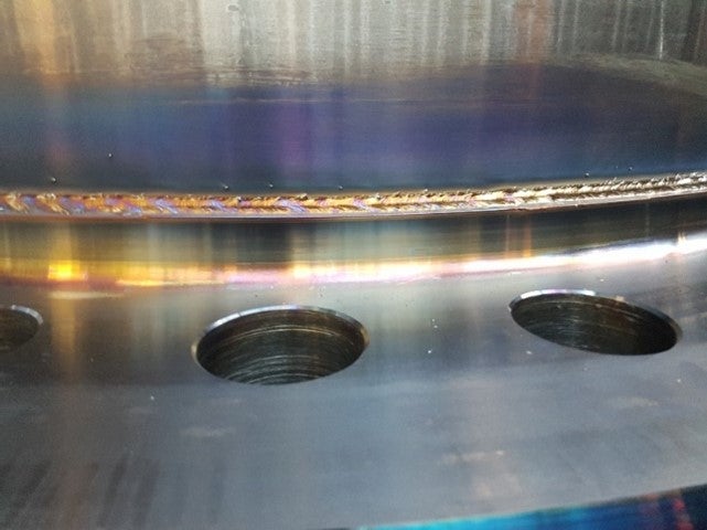

In recent demonstrations, full girth welds on about 1.8‑meter‑diameter components were completed in under an hour of welding time (Figure 1 and 2). What once took seven to eight days using conventional narrow‑gap arc welding can now be completed in less than a day, including setup.
Lower-flange-EBW-electron-beam-welding
1. Lower flange shell mockup electron beam weld—about 6-ft (1.82-m) diameter—completed in 47 minutes. (Note: Mockup is upside down.) Courtesy: EPRI
Lower-flange-Weld-EBW-electron-beam-welding
2. Closer view of girth weld. Courtesy: EPRI
