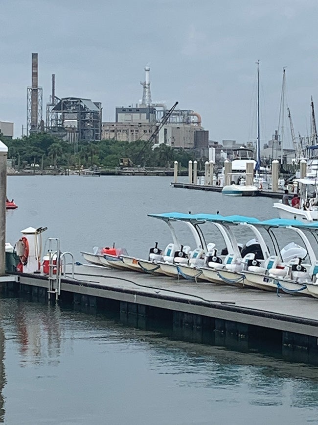

1. The Eight Flags combined heat and power (CHP) plant is situated beside a Rayonier Advanced Materials (RYAM) manufacturing plant. Nearby are the popular tourist destinations of Amelia Island and Fernandina Beach, Florida. Courtesy: Drew Robb
The facility operates as Eight Flags Energy LLC, situated on the RYAM facility in Fernandina Beach on Florida’s Amelia Island (Figure 1). It is a subsidiary of Chesapeake Utilities. It is now almost halfway through a 20-year agreement in which it leases land from RYAM and provides that facility with low-cost steam and other services, as well as supplying power to the FPU grid.

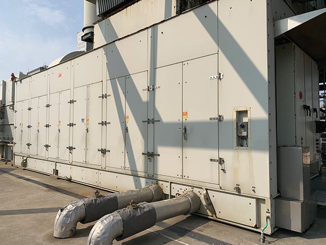

The facility is powered by a Solar Titan 250 gas turbine (Figure 2) that provides anywhere from 20 MW to 23.5 MW depending on conditions and time of year. It is a 16-stage turbo-compressor.
2. The Solar Turbine Titan 250 gas turbine at the Eight Flags CHP plant. Courtesy: Drew Robb
Solar Turbines takes out and replaces the entire cold section (compressor) every 30,000 hours. The Solar Turbines long-term service agreement means Eight Flags is entitled to the latest version of the Solar Titan 250 after 30,000 hours of operation if a new or modified version has been released. As a result, it received the Titan 250E three and a half years ago, which provided 1,800 more horsepower to the unit.
“Every 30,000 hours, we get their best version upgrades as part of the contract,” said Cutshaw. “The latest upgrade introduced new actuators for the inlet guide vanes (IGVs) from Solar, which remain much closer to the prescribed calibration number.”
The semi-annual outage lasts two days and the annual outage lasts four days. Solar sends technicians onsite for each outage to inspect and maintain its turbine, as well as taking care of anything else needed in the interim. Solar monitors the turbine 24/7 remotely and sends advice, alerts, and other information. The original equipment manufacturer can look at the data from the turbine and predict trends that are occurring. Cutshaw added that Solar also sends service bulletins about issues found and advice gained from its large fleet of Solar Titan 250s.
A key maintenance action is to calibrate the IGVs during the annual outage. Solar also deals with the lube oil system, changes the lube oil filters, and performs other maintenance inspections and tasks when onsite.
An outage is scheduled for spring to change out a portion of the inlet air housing. This is being done as minor contamination has been found in the compressor due to corrosion in one part of the inlet air duct that has impacted turbine output slightly.

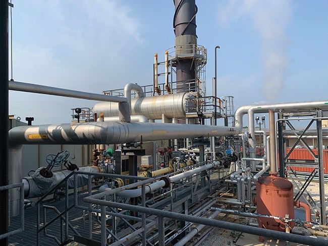

A Rentech HRSG (Figure 3) feeds steam to RYAM at 160 psi and 420F. The HRSG recovers about 70,000 to 75,000 pounds of steam per hour and has the capability to increase that amount using duct burners that add 125,000 pounds per hour of process steam for a grand total of 200,000 pounds per hour, if needed.
3. The Rentech heat recovery steam generator and associated steam lines that feed the RYAM manufacturing plant. It has operated reliably for a decade. Courtesy: Drew RobbDrew Robb
Demineralized water provided by RYAM is channeled through a hot water economizer in the Rentech HRSG to increase the water temperature by 70F. This hot water is sent back to RYAM for use in production processes. Heating of demineralized water saves RYAM from having to generate its own power to heat the water. This also helps them to keep emissions low at their facility. Exhaust heat is also used to heat feedwater before it is sent into the HRSG.
As the duct burner’s steam output is not routed through the combustion management system, regulatory requirements impose a yearly cap on natural gas consumption for duct burning. Eight Flags has historically remained well below this prescribed limit.
A boiler inspection is scheduled every two years to ensure the boiler is operating within specifications. Eight Flags changes the pressure relief safety valves on the HRSG every two years, not due to problems, but as a precaution as they are critical to facility safety.
As the site is essentially in a salt marsh, it is in a highly corrosive environment. Additionally, the massive RYAN manufacturing plant generates plenty of dust from woodchips and debris. Standard preventive maintenance work is everything. Non-corrosion coatings are liberally applied to plant equipment and the HRSG. Vibration levels are regularly checked and onsite personnel inspect the air and water sides of the HRSG as well as the integrity of the tubes to see if they are losing any material.
“In almost 10 years, we have hardly lost any tubes and have had minimal issues with the Rentech HRSG,” said Cutshaw. “The key to smooth HRSG operation is to have a good HRSG from a reliable vendor and then make sure that water treatment is done well so water quality remains very high.”
A visual inspection of the HRSG is done every outage to check the diverter, make sure there are no hot spots, and that there is no loss of insulation. The plant manager noted that tubes on the HRSG have held up well despite 10 years of constant use. He is not seeing degradation of the tubing, which he puts down to good manufacturing and extremely clean 900-class feedwater.
The boiler itself was intentionally oversized. Most of the time it runs at 75,000 lbs per hour though the HRSG is capable of operating at 200,000 lbs per hour when the duct burners operate. “It is best to oversize the HRSG as you run into fewer maintenance issues and have the option of adding more steam if you need it,” said Cutshaw.
Despite being oversized, the HRSG could still be built and assembled in the Abilene, Texas, facility of Rentech and shipped to Eight Flags in a couple of large modules. Any larger, and the facility might have had to specify a stick-built unit, which would have added to costs, introduced onsite construction complexity, and increased the timeline.
Waste heat is used in the HRSG to make steam, but the heat left over is harnessed by using an economizer to heat feedwater for the boiler and demineralized water for RYAM. Effective use of waste hear raises overall efficiency at Eight Flags to 80%.
