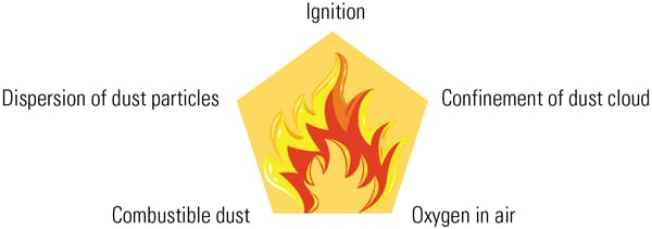

Plants can no longer sweep coal dust under the rug and ignore the health and safety hazard it presents, because a single spark can cause a dust explosion that could put a plant out of service, perhaps permanently. Managing dust in a power plant begins with good housekeeping, followed by retrofits using properly designed equipment.
On February 7, 2008, at about 7:15 p.m., a series of huge explosions and fires occurred at the Imperial Sugar refinery northwest of Savannah, Georgia, causing 14 deaths and injuring 38 others, 14 seriously. The facility, which converted raw cane sugar into granulated sugar, had a material-handling system that included the familiar railcar unloader, belt conveyors, bucket elevators, and silo storage. The explosions were fueled by massive accumulations of combustible sugar dust throughout the packaging building.
The initiating explosion occurred in the enclosed belt conveyor below the silos. That explosion lofted the dust accumulated on floors and elevated surfaces throughout the buildings. Secondary explosions and fires heaved thick concrete floors and collapsed brick walls, blocking stairwells and exit routes. The destruction, as shown in the photo above, was complete.
The U.S. Occupational Safety and Health Administration (OSHA) reports that between 1980 and 2008, 422 combustible dust incidents were reported across 64 different industries; electric power generating utilities experienced 28 incidents. The U.S. Chemical Safety and Hazard Investigation Board (CSB) investigates and documents the causes of these industrial dust explosions. Each of the CSB dust explosion reports suggests a common cause: Companies and their employees failed to recognize the implicit danger of airborne and accumulated dust.
The explosion at the Imperial Sugar plant prompted the U.S. House of Representatives to pass a bill requiring OSHA to adopt the National Fire Protection Association (NFPA) recommendations to prevent explosions caused by combustible dust (see “Five Requirements for a Dust Explosion”), although it never became law.
Today, OSHA’s instruction No. CPL 03-00-008 is the guiding directive for controlling dust in manufacturing facilities. CPL 03-00-008 and NFPA 654 define the conditions under which plants must immediately remove dust accumulations that are 1/32 inch thick. OSHA standard No. 29 CFR 1910.269(v)(11)(xii) requires the elimination or control of ignition sources when coal-handling operations may produce a combustible atmosphere. NFPA 654, which includes a comprehensive list of dust control, ignition sources, and damage control provisions, is also an invaluable reference.
A good understanding of what these instructions require (and following through on upgrades, as required) will make your next OSHA inspection much less stressful. The sidebar “Prepare for Inspections, Not Citations” describes what happens during a typical OSHA visit.

  1. Identify the factors that may contribute to an explosion by a hazard assessment of the handled materials, plant operations, spaces (including hidden ones), and potential ignition sources.
  2. Implement a hazardous dust inspection, testing, housekeeping, and control program.
  3. Control ignition sources using appropriate electrical equipment and wiring methods (the “Know Your Area Classifications” sidebar describes the importance of properly selecting the correct electrical area classification); eliminate or control static electricity, smoking, open flames, sparks, friction, and heating surfaces; and use an equipment preventive maintenance program.
  4. Reduce the risk of injury and equipment damage via separations, segregation, isolation, venting, fire protection, explosion prevention systems. Develop an emergency action plan, and maintain emergency exit routes.
In a practical sense, the first step in eliminating the hazard is to understand dust formation processes and which dust control technologies will be most effective to reduce airborne dust at the source. The available technologies are usually classified as containment, suppression, collection, and flow control. Each individual technology will reduce dust formation at the source, but a holistic approach should be considered for the entire plant. Each technology is discussed in more detail in the following sections.
