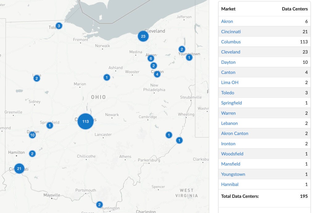

The new 9.2-GW power project will likely feed intense power demand growing in central Ohio, where land availability, transmission access, and proximity to consumers make development attractive for data centers. According to the Office of the Ohio Consumers’ Counsel, Ohio has about 200 data centers, making it the fifth-highest state in the country, though most are in Central Ohio.
ART: This map illustrates the distribution of 195 data centers across Ohio, highlighting major concentrations in metropolitan hubs. The Columbus market dominates the landscape with 113 facilities, followed by Cincinnati (21) and Cleveland (23). Smaller regional clusters and individual facilities are also visible in areas such as Akron, Dayton, and Ironton, reflecting the state's growing role as a critical infrastructure hub for cloud and AI services. Portsmouth is in southern Ohio, near the state’s border with Kentucky. Source: Data Center Map (Feb 2026).
ART: This map illustrates the distribution of 195 data centers across Ohio, highlighting major concentrations in metropolitan hubs. The Columbus market dominates the landscape with 113 facilities, followed by Cincinnati (21) and Cleveland (23). Smaller regional clusters and individual facilities are also visible in areas such as Akron, Dayton, and Ironton, reflecting the state’s growing role as a critical infrastructure hub for cloud and AI services. Portsmouth is in southern Ohio, near the state’s border with Kentucky. Source: Data Center Map (Feb 2026).
AEP Ohio, a utility that serves the region, has suggested that data center load in central Ohio grew from 100 MW in 2020 to around 600 MW in 2024. AEP Ohio forecasts that load could rapidly accelerate to reach 5 GW in Central Ohio by 2030. In July 2025, Ohio regulators approved the utility’s landmark tariff structure requiring large new data center customers to pay for a minimum of 85% of their subscribed electricity usage—regardless of actual consumption—for up to 12 years.
