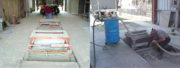

As the first line of defense in housekeeping routines to prevent catastrophic explosions caused by combustible dust and comply with regulatory agencies, plant personnel need to employ industrial vacuum cleaners that are built from the bottom up to be used in a variety of Class II, Division 2 areas (Figure 4). Redundantly grounded industrial vacuum cleaners are designed to shield workers and property from catastrophic secondary coal dust explosions.
4. Housekeeping helper. Cleaning up the abundant dust around the boot seals in this cement plant is more effective with the VAC-U-MAX air-operated industrial vacuum cleaner than with shovels and wheel barrows. Courtesy: VAC-U-MAX

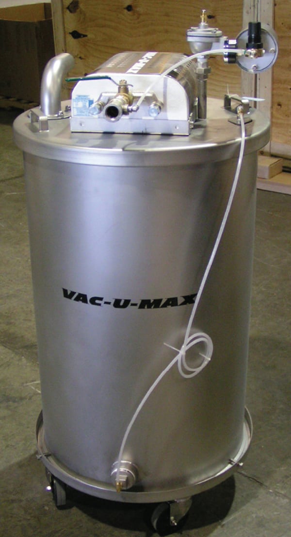

The VAC-U-MAX company developed the first air-operated industrial vacuum in 1954 and has been the pioneer in solving vacuum-related challenges in a wide range of manufacturing and industrial settings (Figures 5 and 6).
5. Intrinsically safe systems. The VAC-U-MAX compressed air–powered vacuums meet regulatory requirements for grounding and bonding. Employing this type of industrial vacuum cleaner that is redundantly grounded eliminates the possibility of any kind of explosion from the vacuum. Courtesy: VAC-U-MAX

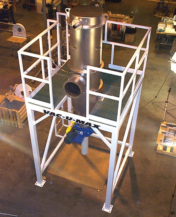

6. Modularity maximizes usage. Like the VAC-U-MAX central vacuum system shown in Figure 5 that has an explosion vent, most vacuums are modular in nature. Standard equipment with additional capabilities can be added to the vacuums for specific applications. Courtesy: VAC-U-MAX

Employing an industrial vacuum cleaner that is redundantly grounded in five different ways “eliminates the possibility of any kind of explosion from the vacuum,” Bobbitt explained. Although VAC-U-MAX does produce electric vacuums designed for Class II, Division 2 environments, the most economical solution for cleaning combustible fugitive coal dust is the company’s air-operated vacuums. This type of vacuum is safer in terms of grounding, and it also works more efficiently in the industrial environment.
Beyond the fact that VAC-U-MAX air-operated vacuums use no electricity and have no moving parts, the first of the five ways that these vacuums are grounded begins with the air line that supplies compressed air to the units. Because most plants have compressed air lines made from iron that conduct electricity, the company’s air-operated vacuums use static conductive high-pressure compressed air lines. In addition to the static conductive air lines, static conductive hoses, filters, and casters are employed to further reduce risk. Furthermore, a grounding lug and strap that travels from the vacuum head down to the 55-gallon drum is used to eliminate the potential for arcing.
