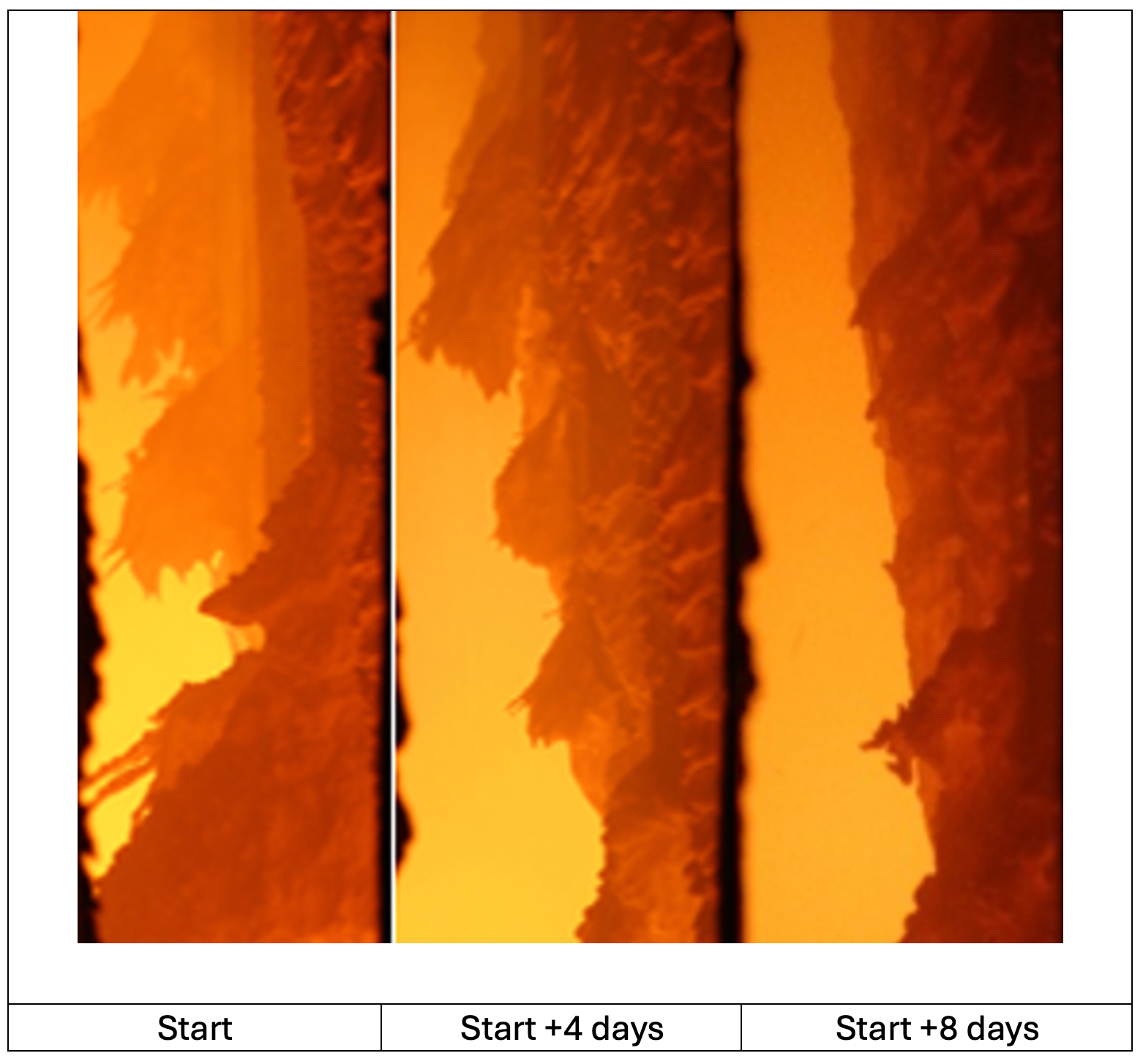

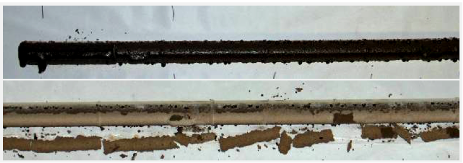

Changes in ash chemistry can be observed through high-temperature probe (HTP) testing that simulates tube-surface conditions (Figure 1). Probe accumulations and associated temperature mapping data consistently show reduced slag adhesion and no or reduced “black glass” formation, validating the chemistry’s effectiveness in actual furnace operating conditions (Figure 2).  HTP testing, along with furnace infrared photography/thermography conducted during field trials can be used to verify performance in short demonstration programs.
1. Baseline high-temperature probe (HTP) testing in a Powder River Basin (PRB)-fired 640-MW opposed-wall furnace illustrates how CoalTreat reduces boiler tube slagging. The untreated fuel produced a thick layer of black amorphous glass that accumulated on the HTP (top). The test was repeated one day later with CoalTreat applied to the fuel. Notably, the slag coating on the HTP was more porous, friable, and weakened such that it broke off as the HTP was removed (bottom), confirming the change in ash crystal structure. Courtesy: EES
2. Progression of pendant slagging under baseline conditions and after four and eight days of treatment. The reductions in slag accumulation are clearly present, highlighting the effectiveness of the additive treatment. Courtesy: EES

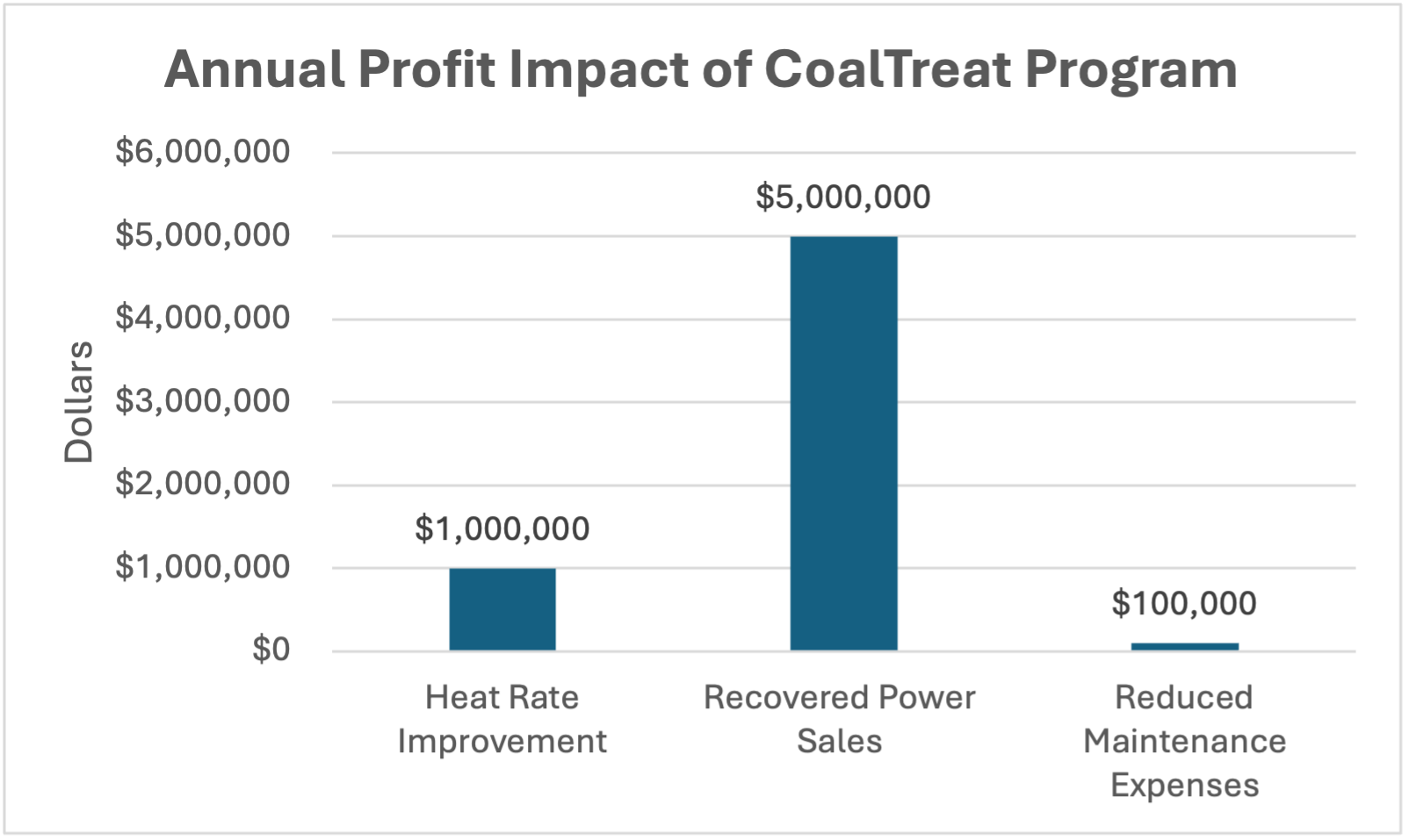

The savings from heat-rate improvement contribute approximately $1.0 million annually to the plant’s bottom line.  Recovered power sales generated a net income of about $5 million per year (after fuel costs), based on an average power sale price of $100/MWh. Maintenance savings from reduced boiler cleaning and weld repairs eliminated roughly $100,000 in annual maintenance expenses.

3. Case study findings emphasize a key point: coal units can regain lost MW and boost profitability through targeted, data-driven fuel chemistry rather than costly retrofits. As shown, optimized combustion and slag-mitigation chemistry delivered several million dollars in annual net profit, driven by improved heat rate, increased power sales, and reduced maintenance costs. Courtesy: ESS

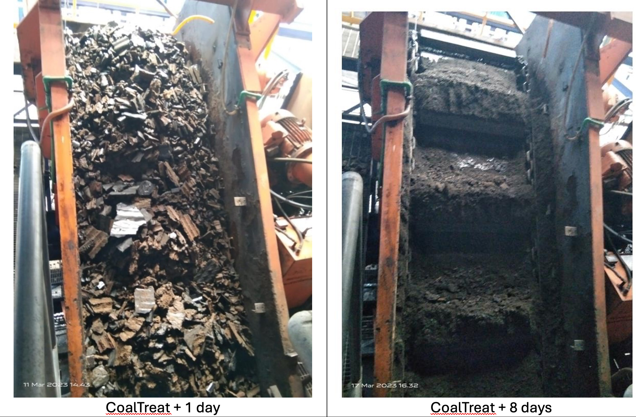

In the age of AI and “big data,” coal isn’t finished yet. By embracing targeted innovation and smarter fuel chemistry, operators demonstrate that legacy assets can adapt (Figure 4), delivering cleaner, more reliable, and cost-effective power when the grid needs it most.
4. CoalTreat’s impact on furnace slagging can be seen as waterwall and pendant slag shedding is observed within the first day of treatment. After a week of continuous treatment, the finer, friable consistency of treated bottom ash is observed. Courtesy: EES
