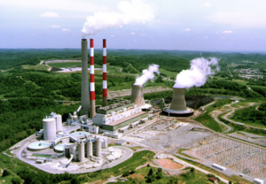

The 1,098-MW Fort Martin Power Station is located in Maidsville, West Virginia, on the Monongahela River. It has two coal-fired units. It is owned by Monongahela Power (Mon Power), part of FirstEnergy Corp. Source: Mon Power
