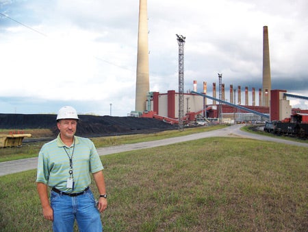

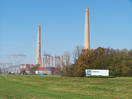

Tennessee Valley Authority’s (TVA) Shawnee Fossil Plant sits on 2,696 acres on the south bank of the Ohio River about 10 miles northwest of Paducah, Kentucky. The plant is a local landmark, easily recognizable by its 10 original stacks flanked by two tall stacks stretching 800 feet into the sky (Figure 1). Its stacks may stand out in the landscape, but it’s the plant’s operations reputation that’s truly outstanding.
