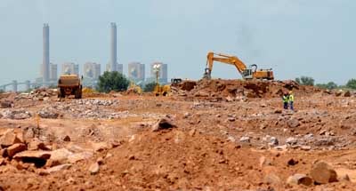

This coal-fired baseload power station in Lephalale, Limpopo Province, will comprise six units rated, in total, at 4,788 MW installed capacity when fully completed in 2015 (see photo). These units are planned to be direct dry-cooled units such as those at Eskom’s Matimba power station in the same province. The unit’s construction was begun in April 2008. Hitachi and Alstom have been awarded the boiler and turbine contracts.
When it rains, it pours. With a name meaning “the rain that soaks parched land, giving economic relief,” Eskom has high hopes for the six-unit 4,788-MW Medupi power station it is currently building in South Africa’s northernmost Limpopo province. A second coal-fired project, the 4,818-MW Bravo power station, is also under way in the same region. Courtesy: Eskom
