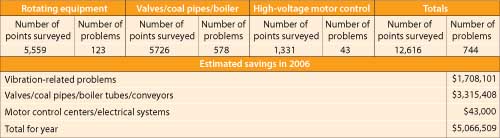

All of the data collected became the basis of the cost/benefit analysis of estimated future cost savings. Mirant recorded individual data points on a regular basis until 1998, when it decided to simplify the analysis by using an average figure per problem identified. Based on 1998 figures for each vibration-related fault, the utility saved $13,887 per incident. The total included savings of $5,736 for valves and coal piping, and $1,000 for each motor control center (MCC)/electrical problem detected.
According to Humphrey, using averages is sufficient to produce ballpark estimates of the benefits achieved by deploying the CM system. On occasion, Mirant engineers perform a detailed analysis of the cause of a significant fault. Humphrey says that these analyses almost always confirm that averaging yields conservative estimates of benefits. The table shows the estimated savings produced by Mirant Mid-Atlantic’s system in 2006, delineated by equipment type.
Summary of equipment monitored and estimated savings in 2006. Source: Mirant Mid-Atlantic

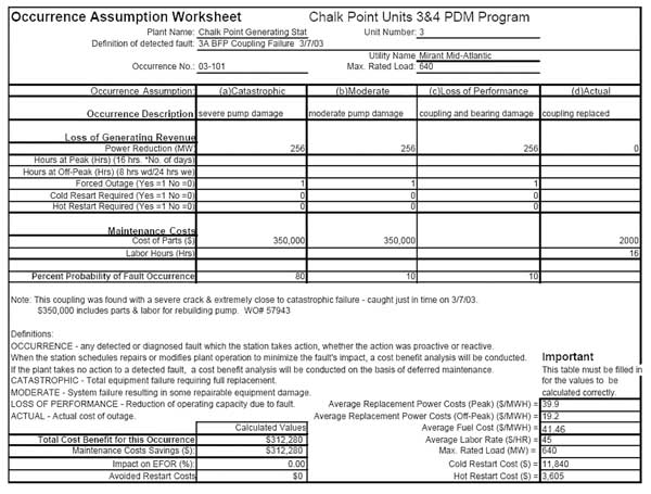

Here’s an example of how the CM program works in practice. In March 2003, a routine vibration survey detected a step increase in vibration on the inboard bearing of a turbine-driven boiler feedpump. Noting the reading, operators immediately reduced the pump’s speed and took the unit out of service later that day. A subsequent analysis (see figure) indicated the probability of a coupling problem.
The cost/benefit analysis worksheet for a boiler feedpump. Courtesy: Mirant Mid-Atlantic
When maintenance staffers inspected the coupling, they found that it was no longer lubricated and had a significant crack. If the vibration had gone undetected, a very expensive catastrophic failure would likely have occurred. Mirant estimated that repairing the collateral damage to the pump, and buying power to replace the lost production from the affected unit while it was out of service for an extended period, would have cost more than $300,000. After replacing the coupling, the pump was returned to service, and vibration returned to acceptable levels.
