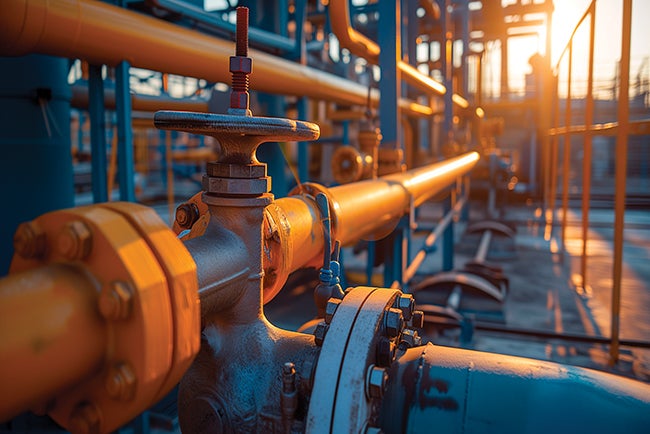

The first element addresses fugitive methane emissions throughout the natural gas supply chain. Methane is the primary component of natural gas. It is considered a “super-pollutant” because it has far more warming impact than a comparable amount of carbon dioxide. As a result, even relatively small methane leaks can have a significant impact on the climate footprint of natural gas–fired electricity.
Consider that a modern combined-cycle gas plant with a heat rate of approximately 6.5 MMBtu per MWh emits roughly 345 kilograms (kg) of carbon dioxide (CO2) per MWh from combustion. To produce that electricity, the plant consumes approximately 125 kilograms of methane. If the gas supply chain leaks 1.5% of the product (Figure 1), approximately 2 kg of methane are emitted for every MWh generated. Using the United Nations’ latest assessment of the global warming potential of methane, those methane emissions contribute roughly 155 kg of CO2-equivalent (CO2e) emissions per MWh. Thus, lifecycle emissions are about 500 kg of CO2e per MWh: 345 kg from combustion and 155 kg from upstream methane leakage.
1. Fugitive methane emissions, including from valves, flanges, and fittings, can account for supply-chain losses of more than 1%. Courtesy: Envato / kostinat
Now consider a lower-emissions gas supply with a leakage rate of just 0.2%, which is attainable today. Methane emissions fall to 20 kg of CO2e. Thus, total plant lifecycle emissions are approximately 365 kg of CO2e per MWh (the 345 kg referenced above + 20 kg), a reduction of more than 25% of total lifecycle emissions relative to using conventionally produced gas. Importantly, this reduction can be achieved without changing the power plant itself and without delaying construction schedules. Thus, lower-emissions gas represents one of the fastest available emissions-reduction opportunities.

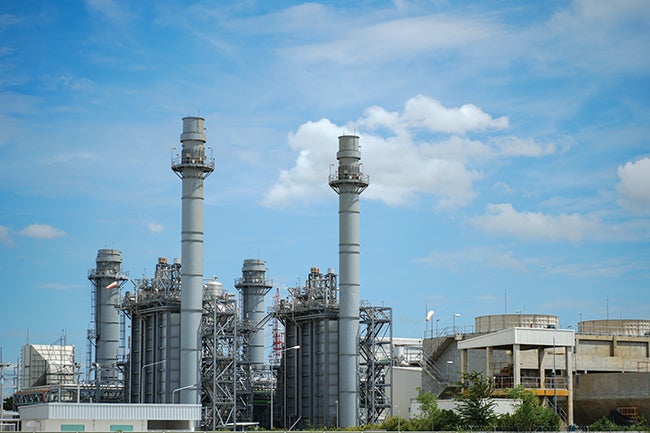

The math above assumes new gas-fired generation is built using combined-cycle technology. Combined-cycle plants produce significantly more electricity from each unit of fuel than simple-cycle turbines, reducing both fuel costs and emissions. Because AI data centers are expected to operate continuously and at high utilization rates, combined-cycle facilities are the most economical long-term gas-fired solution, with their higher efficiency more than offsetting their approximately 10% to 30% higher upfront capital cost.
Combined-cycle plants (Figure 2) raise efficiency by using the hot exhaust gases from the gas turbine to produce steam in a heat recovery steam generator (HRSG), which then drives a separate steam turbine to generate additional electricity from energy that would otherwise be wasted. As a result, combined-cycle facilities typically achieve 55% to 65% thermal efficiency, compared with 35% to 40% for simple-cycle gas turbines, allowing them to produce substantially more electricity from the same amount of fuel while reducing both operating costs and emissions per MWh.
2. Combined-cycle plants use heat recovery steam generators (HRSGs) to convert gas turbine exhaust into additional electricity, boosting overall efficiency. Courtesy: Envato / Kenstocker
