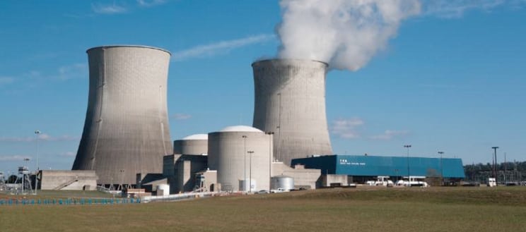

But Browns Ferry Unit 1 (Figure 1) remained in stasis. Not dead, but in a deep administrative coma.
1. Successful restart. Browns Ferry Unit 1 was restarted in May of this year after a five-year, $1.8 billion overhaul. It had been idled since 1985, when it was shut down because of plant management and operations concerns. Courtesy: TVA
