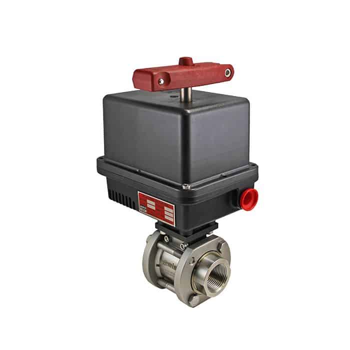

However, not all ball valves are designed for repair. In many cases, it’s more practical to replace a worn valve rather than attempt repairs, especially for non-serviceable models. For valves designed with reparability in mind, maintenance is straightforward and allows for the replacement of individual components like seals, seats, and any other parts within the valve that are prone to wear. This style of ball valve is typically referred to as a 3-piece ball valve (Figure 1).
1. The valve shown here is a 2-inch stainless steel electric-actuated 3-piece ball valve. Courtesy: Gemini Valve
With actuated ball valves, the valve is often a fraction of the cost of the full assembly, and typically the first component to fail. It can be replaced fairly economically, and one actuator will likely last the life of a number of ball valves.
