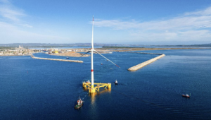

BIO-UV Group has completed the first commercial deployment of its containerised BIO-SEA ballast water treatment system (BWTS) at Port-la-Nouvelle in southern France, supporting the installation of the pioneering EFGL floating offshore wind project in the Mediterranean.
The landmark project, operated by Eoliennes Flottantes du Golfe du Lion (EFGL)—a project owned by Ocean Winds and Banque des Territoires—marks the first floating offshore wind development in Occitanie region (French Mediterranean Sea) and is a significant milestone for the integration of marine environmental technologies into the renewable energy supply chain.
BIO-UV’s containerised system was used to treat the water deballasted from three floating wind turbine platforms—each comprising three floaters arranged in a triangular structure—before their deployment offshore. The deployment was announced October 23.
The rental agreement, signed with Euroports in May 2025, enabled Euroports to provide compliant deballasting services including the water treatment to EFGL during the assembly and installation phase. The first platform arrived from Fos-sur-Mer near Marseille in early July, followed by the second in mid-July and the final unit in August. Over the course of approximately two months, BIO-UV treated the ballast water of all three platforms in full compliance with IMO D-2 standards and local environmental regulations, before safe discharge back into the port basin.
