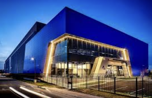

Aligned Data Centers and Calibrant Energy have announced what the companies call a first-of-its-kind energy solution to address one of the data center industry’s most urgent constraints: access to grid power. The Oct. 22 announcement comes as the rapid growth of artificial intelligence (AI) and advanced computing fuels unprecedented power demand, accelerating the need to increase load service and ensure reliable access to grid power.
Under the agreement, Calibrant, a premier provider of on-site energy solutions for large power users, will deliver a 31-MW/62-MWh battery energy storage system (BESS) at Aligned’s data center campus in the Pacific Northwest. The on-site system, planned to be operational in 2026, will enable the facility to come online and scale operations years earlier than would be possible with traditional utility upgrades.
Calibrant and Aligned have been partnering with a regional utility in the Pacific Northwest since the start of negotiations to explore flexibility as a means to increase and accelerate interconnection. Aligned’s adaptive data center solutions power customers’ most demanding cloud, AI/high-performance compute (HPC), and enterprise workloads.
