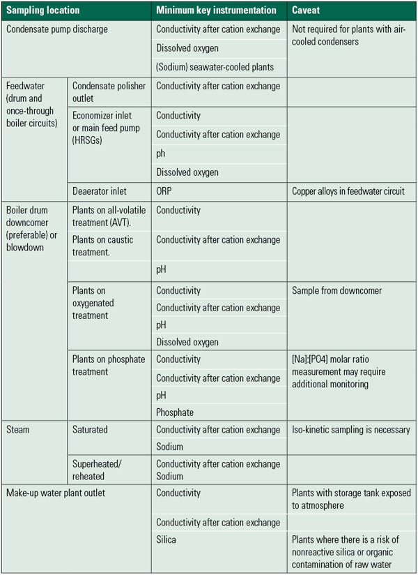

The recommendations of the Electric Power Research Institute, American Society of Mechanical Engineers, and, most recently, the International Association of the Properties of Water and Steam (IAPWS) require online continuous analysis of all parameters that are critical to minimizing corrosion and deposit formation in the boiler or turbine. Each of the water chemistry parameter limits set by these industry organizations links directly back to specific failure mechanisms in the steam and water cycles. These published recommendations give us guidance as to the parameters monitored and their concentration levels. This information also tells us the type of equipment and the accuracy requirements of equipment purchased for the plant water laboratory. For example, the IAPWS recently published recommendations for the concentrations of key parameters used to monitor the steam cycle (Table 1).
Table 1. Summary of minimum key instrumentation requirements for power plant water analysis. Source: IAPWS Technical Guidance Document: Instrumentation for Monitoring and Control of Cycle Chemistry for the Steam-Water Circuits of Fossil-Fired and Combined-Cycle Power Plants, September 2009.
