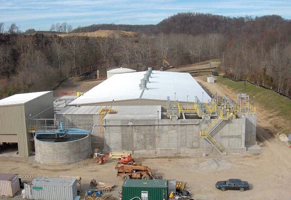

Dunkard Creek Water Treatment Systems, an affiliate of Longview Power, contracted Veolia Water Solutions & Technologies (Veolia) to design and build a river water treatment system to provide makeup water for the power plant (Figure 1). About 80% of the treated water will be used as makeup for the plant’s cooling tower; the remainder will go to its steam generator, scrubber, and various other plant uses.
1. Smart water makeup. The new Longview Power coal-fired plant uses river water. Approximately 80% of the water treated at the plant will serve the plant’s cooling tower; the remainder will go to its steam generator, scrubber, and various other uses. The water treatment processes used are based on the quality of the river water and the intended use. Courtesy: Veolia Water Solutions & Technologies
Veolia designed and built the facility, integrating its Actiflo high-rate clarification, multimedia filtration, and reverse osmosis (RO) technologies with microfiltration and RO equipment that Longview Power had previously purchased for the cancelled acid mine water treatment plant. The ability to incorporate owner-supplied equipment into the new treatment system design resulted in substantial capital cost savings.
