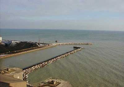

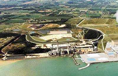

The 1,135-MW Oak Creek Power Plant (OCPP) has four operating units that have used CW from Lake Michigan since 1953 (Figure 1). The original intake channel extends from the shoreline to about 900 feet into the lake (Figure 2). That intake channel is about 250 feet (ft) wide and 20 ft deep under the low-water datum. The channel width narrows to about 200 ft as it approaches the inlet of the existing OCPP pump house intake. The pump house has four pumps designed for approximately 800,000 gpm.
1.    The Oak Creek Power Plant. The two-unit Oak Creek Power Plant Expansion Project is now under construction on plant property located to the right of the existing plant. Courtesy: Bechtel Power Corp.
2.    Short intake channel. The existing shoreline intake channel was only 900 feet long. The Clean Water Act Section 316(b) upgrade now takes water from Lake Michigan at a distance of 1.5 miles offshore. Courtesy: Bechtel Power Corp.
