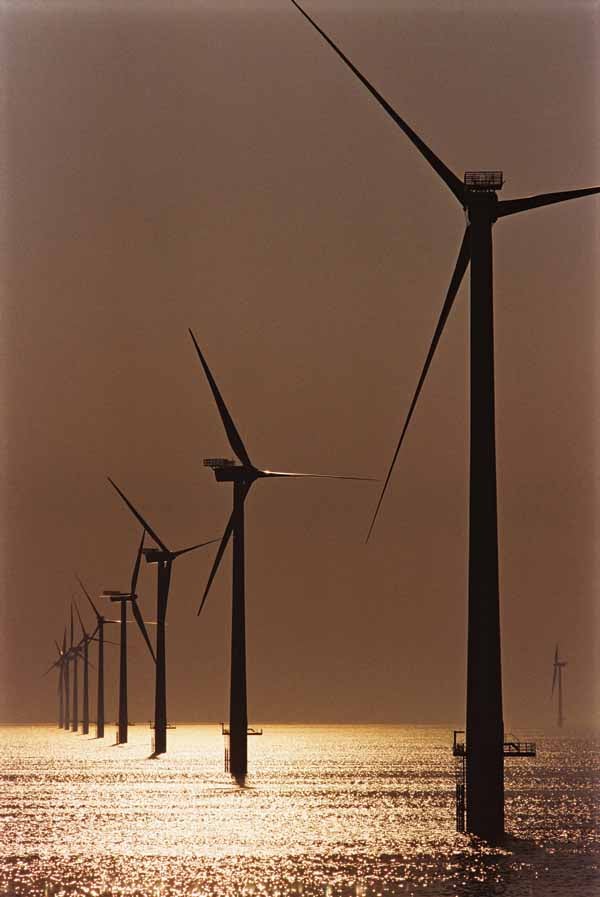

Denmark in September inaugurated a 209-MW offshore wind park — the world’s largest to date — off the west coast of Jutland, in the North Sea. Owned 60% by Vattenfall and 40% by DONG Energy, construction of the massive Horns Rev 2 project — consisting of 91 Siemens 2.3-MW turbines (Figure 6) — began in early 2008 as the second phase of the Horns Rev project. The first phase, the 160-MW Horns Rev 1, which uses 80 Vestas 2-MW turbines, began feeding the Danish electricity grid in 2002. It was the first offshore wind farm built in the North Sea.
6.    Treading water. Denmark inaugurated the world’s largest offshore project to date this September. But the 91-turbine, 209-MW Horns Rev 2 wind park—built in just 18 months off the west coast of Jutland on the North Sea—could soon be overtaken in size and installed capacity by several planned wind farms, including British projects like the 140-turbine Greater Gabbard and the 340-turbine London Array. Courtesy: Vestas Central Europe
The size of the Horns Rev 2 park is reportedly so vast that it features the world’s first offshore wind farm equipped with a platform where maintenance personnel can spend the night. It is expected to produce more than 800 GWh of electricity annually, making Denmark — a country that already receives about a fifth of its electricity from wind power — the worldwide leader of installed offshore wind capacity.
