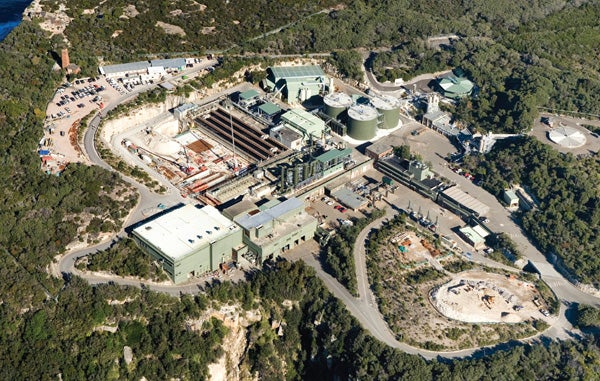

An Australian sewage plant this April began using treated wastewater falling down a 60-meter (m) shaft to produce its own power. The unique 4.5-MW hydroelectric plant, installed as part of a A$150 million (US$124 million) upgrade to North Head sewage treatment plant (Figure 4), is one of three new units the New South Wales government is installing in Sydney Water’s water and sewerage networks.
4. Waste waterfall. Australia’s North Head Sewage Treatment Plant started up a 4.5-MW small hydro unit that harvests power from treated wastewater falling down a 60-meter shaft. The sewage plant, located on the North Head Peninsula at the entrance to Sydney Harbour, near Manly, serves a population of over one million people and treats about 300 million liters of flow a day. Treated effluent is discharged through a deepwater ocean outfall. Courtesy: Sydney Water
