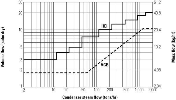

The methodology for selecting vent equipment capacity from the HEI’s Table 9 is explained in the HEI standards and should be carefully followed. In general, the standard is based on the number of openings exhausting steam to the condenser and the effective steam flow through each opening. Note that the German VGB code is significantly different regarding the requirement for air-venting equipment (Figure 1). In fact, the VGB code is approximately 50% less stringent than the HEI standard requirements. Your purchase specification should clearly indicate whether the equipment should meet the HEI standards or the VGB code.
1. Pick your standard. The Heat Exchange Institute (HEI) standards and the German VGB code have significantly different dry-air vent requirements for vacuum equipment. Source: Gardner Denver Nash
