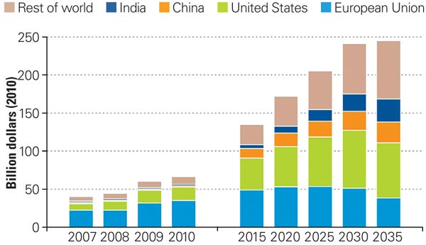

Renewables expand significantly in all three scenarios—and especially in the New Policies Scenario, where they triple, from 3,900 TWh in 2009 to 11,100 TWh in 2035, driven by government policies, including subsidies (Figure 2). The bulk of this growth comes from wind and hydro (about 33% each); biomass accounts for about 17% and solar photovoltaic (PV) for about 10% of all renewable generation.
2. Continued support. Global subsidies to renewables-based electricity and biofuels by region in the New Policies Scenario are set to increase, with renewable subsidies increasing from $66 billion in 2010 (compared with $409 billion for fossil fuels) to $250 billion in 2035, the International Energy Agency says. Courtesy: IEA
The U.S., China, EU, and India will see the most wind growth (almost 75%) and about 70% of solar PV growth. Ultimately, China will be the world’s leading onshore wind power producer. The IEA suggests that solar PV is also set to grow tremendously, at a rate of 15% per year until 2035. The EU currently accounts for about 75% of global solar PV generation. Europe will continue to see strong growth over the next few years, but between 2020 and 2035, the increases in solar PV generation in China, the U.S., and India will each be larger than in the EU.
