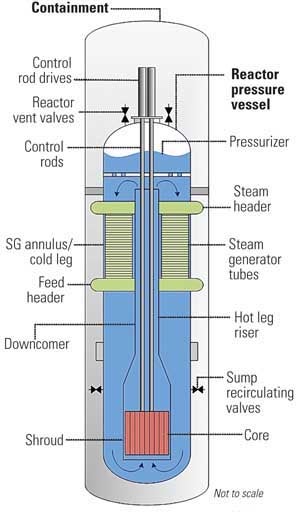

NuScale Power Inc., an Oregon company, is also in the running. Its 45-MW reactor is based on a "multi-application" light water reactor designed by Oregon State University (OSU). The NuScale reactor is a modular unit designed to be built on-site. NuScale estimates that plant construction would take between two and three years. The modular reactor and containment vessel measures about 60 feet in length and 14 feet in diameter. Like other pressurized water reactors, NuScale’s reactor is water-cooled, but it eliminates the many pumps and pipes by working the water through a convection-based "natural circulation system" (Figure 3). The company said that a electrically heated demonstration model one-third the size of NuScale’s reactor at OSU confirmed the effectiveness of the cooling system.
3. Cooling by natural circulation. NuScale Power uses naturally circulated water to cool its mini-pressurized water reactor, eliminating the need for pumps and pipes. Water is heated as it passes over the core. It then rises within the interior of the vessel. Once the heated water reaches the top of the riser, it is drawn downward by water that is cooled passing over the steam generator. It is then pulled by gravity back down to the bottom of the reactor. Water in the reactor system and the steam generator system are kept separate. As the hot water in the reactor system passes over the hundreds of tubes in the steam generators, heat is transferred through the tube walls. Water inside the tubes turns to steam. The steam turns the turbines, which are attached by a single shaft to the electrical generator. Courtesy: NuScale Power
NuScale is prepared to submit an application for design approval to the NRC in 2010. The NRC estimates that its review process will conclude by mid-2013. Because the company employs a familiar technology, according to a February 2008 briefing slide on the NRC’s web site, NuScale could have an advantage over the 4S and hydride reactors. "NRC skill set and tools are lacking for the LMR and hydride reactor," the agency wrote. "With adequate resources and staff, it will take at least 5 years to develop independent capabilities for LMR."
