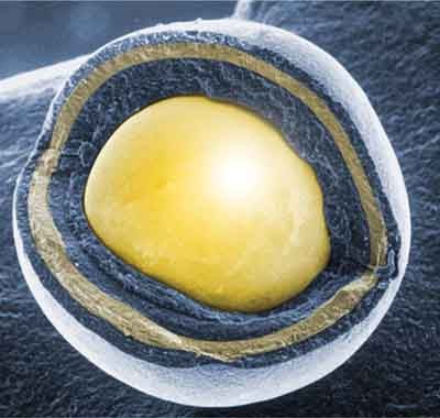

According to INL researchers, it was a great achievement when the advanced nuclear fuel recently set a particle fuel record by consuming about 19% of its low-enriched uranium — more than double the previous record set by German scientists in the 1980s, and more than three times that achieved by current commercial light water reactor fuel (Figure 5). Such high "burnup" levels — a measurement of the percentage of uranium fuel that has undergone fission reactions — can reduce the amount of unused fuel coming out of next-generation reactors, they said.
5. A speck on the horizon.
Researchers at the Idaho National Laboratory announced last November that low-enriched uranium fuel developed for use in next-generation high-temperature gas-cooled reactors showed “burnup” levels of 19%. That is more than double the previous record set by German scientists in the 1980s and more than three times that achieved by current commercial light water reactor fuel. As the artist’s rendering shows here, each fuel particle contains a kernel of enriched uranium surrounded by carbon and carbide layers that act as containment boundaries for the radioactive material. The tiny kernels can range from 350 to 500 microns, and total particle diameters can range from 780 to 920 microns. Source: Idaho National Laboratory
