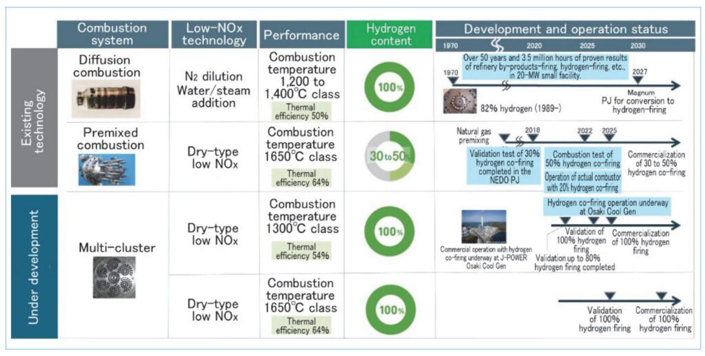

A key demonstration focus has been to verify a dry-low NOx (DLN) pre-mixed multi-nozzle combustor technology, which addresses flashback (backfire), combustion pressure fluctuation, and nitrogen oxide (NOx) emissions. Developed with funding by Japan’s New Energy and Industrial Technology Development Organization (NEDO), Mitsubishi Power in 2018 validated the use of 30% hydrogen by volume in the large frame gas turbine combustor, and in 2022, it validated 50% hydrogen by volume.
However, the integral demonstration unveiled on Thursday “verified the achievement of the same low NOx emissions and stable combustion during hydrogen co-firing, and that switching fuels from natural gas to hydrogen fuel blending is possible during partial-load and full-load operation,” the company said. In 2024, the company plans to “proceed with the expansion of the hydrogen storage facility and perform a demonstration using a 50% hydrogen blended fuel.”
To get to a 100% hydrogen capability, the company has, in tandem, been developing a single-fuel “multi-cluster” combustor technology that enables efficient mixing of hydrogen and air via an upgraded fuel delivery nozzle design. Hydrogen co-firing using the novel combustor at a 1,300C-class gas turbine is underway at J-POWER’s Osaki Cool Gen project, a 2017-completed integrated gasification combined cycle (IGCC) plant in Hiroshima Prefecture.
Mitsubishi Power’s development of a 1,650C-class multi-cluster combustor is also underway. Combustion tests are slated in 2025, and the company is eyeing commercialization by 2030, “when hydrogen is expected to be in sufficient supply.”

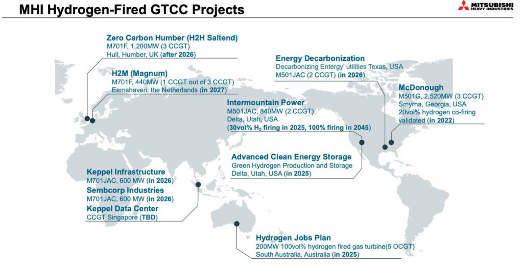

Commercialization of Mitsubishi Power’s hydrogen capabilities will be on full display at the Advanced Clean Energy Storage Project in Delta, Utah. The 300-GWh integrated hydrogen system that is shaping up to be the largest renewable hydrogen energy hub in the U.S. envisions producing up to 100 metric tonnes per day of hydrogen from water and renewable energy sources using a HydrogenPro 220-MW high-pressure alkaline electrolyzer bank. It will store that hydrogen in two gigantic solution-mined caverns sited in the only salt dome in the Western U.S and then provide that hydrogen to two M501JAC gas turbines, which Mitsubishi Power recently delivered to the 840-MW IPP Renewed project.
The two turbines will be capable of utilizing a fuel blend of 30% hydrogen by volume when they begin operation in 2025. Under a 20-year long-term service agreement (LTSA), Mitsubishi Power will incrementally increase the amount of hydrogen in the fuel mix as available from the adjacent ACES Delta project to achieve a 100% hydrogen combustion volume by 2045, catering to California’s stringent mandate for carbon-free power.

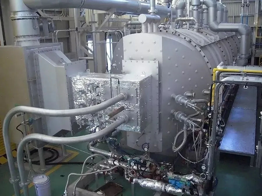

On Tuesday, the company announced it successfully completed a combustion test of an ammonia single-fuel burner at its Nagasaki District Research & Innovation Center, a dedicated test facility in Nagasaki district, Japan.
“Utilizing a combustion test furnace with fuel consumption of 0.5 tons per hour (t/h), MHI conducted a single-fuel burner test using an ammonia burner and a high-ratio ammonia co-firing test with coal,” the company said. “In both cases, the tests confirmed stable combustion, reduced NOx emissions compared to coal firing, and complete combustion of the ammonia.”

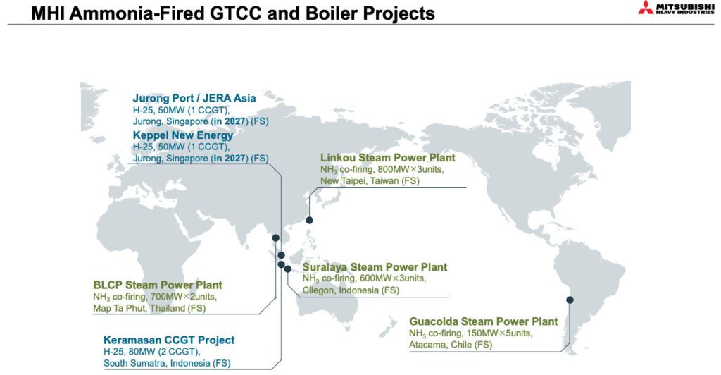

JERAa joint venture between Tokyo Electric Power Co. (TEPCO) and Chubu Electric that is looking to shift its massive coal-fired fleet to 100% ammonia by 2050—is already working to establish the technology and co-fire up to 20% ammonia at the 1-GW Unit 4 of JERA’s 4.1-GW Hekinan Thermal Power Station, beginning in fiscal year 2024. On Nov. 29, JERA President Hisahide Okuda told reporters the project is on track to begin in March 2024. Plans call for increasing ammonia co-firing to more than 50%, with an actual power plant demonstration in 2028/2029, and potentially the start of commercial operation in the early 2030s.
Earlier this year, JERA and MHI signed a memorandum of understanding (MOU) with Thailand’s Electricity Generating Public Company Ltd. to assess the feasibility of up to 20% ammonia co-firing at the 1.4-GW coal-fired BLCP power plant. JERA, meanwhile, has MOUs to study ammonia co-firing with Aboitiz Power, a coal generator in the Phillippines. MHI has a similar agreement with Chilean independent power producer Guacolda Energia, as well as several other entities.

MHI and JERA have joined forces to explore ammonia-firing in gas turbines, too. In August 2022, the two companies set out to jointly explore establishing a 100% ammonia-fired combined cycle plant on Jurong Island in Singapore. Under an MOU, the two entities will study establishing a 60-MW class gas turbine combined cycle plant.
Jurong Island, notably, has emerged as a hotspot for hydrogen and ammonia combustion activity. MHI is, in addition, fielding another potential opportunity with Singapore energy infrastructure developer Keppel Infrastructure and DNV for a 100% ammonia-fueled gas turbine or combined cycle system. And as POWER recently reported, Sembcorp Industries, GE Vernova, and Japanese heavy industry firm IHI Corp. are also jointly examining potentially retrofitting two GE 9F gas turbines at an 815-MW gas-fired combined cycle power plant in Singapore with ammonia capabilities.
