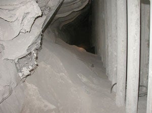

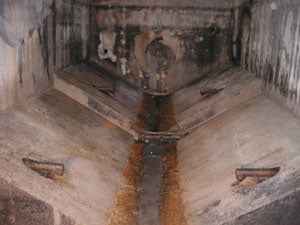

Refractory failure is a major cause of boiler energy losses as well as a major contributor to boiler outages. Understanding why a refractory material fails requires a complex analysis of many interrelated factors: materials that don't match the operating environment, incompatibility with the by-products of fuel combustion, and improper installation techniques (Figures 1 and 2).
Courtesy: BRIL Inc.
1. Ash me no questions. Flyash inside a penthouse between the screen, superheater, and reheater.

2. Unprotected section. A wet bottom-ash hopper with areas of missing refractory.
