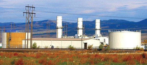

NorthWestern Energy’s (NWE’s) Dave Gates Generating Station (DGGS), formerly the Mill Creek Generating Station, was constructed as a “regulating reserve” plant to provide highly flexible reserve capacity for a grid with increasing nondispatchable renewable energy sources. The $185 million plant—purportedly the first built specifically for electrical transmission grid regulation duty—has increased grid reliability, provides a rapid ramp rate resource, and can operate at low loads, which minimizes fuel costs.
The 150-MW natural gas–fired plant—which was renamed in March 2011 in honor of the late Dave Gates, NWE’s vice president of wholesale operations—began commercial service on January 1, 2011 (Figure 1). It is located at Mill Creek, near Anaconda, Mont., northwest of Butte.
1. Regulating reserve plant. NorthWestern Energy’s Dave Gates Generating Station consists of three Pratt & Whitney Power Systems 50-MW Swiftpacs. Also shown is the 500,000-gallon raw water storage tank on the right and the 500,000-gallon demineralized water storage tank on the left. Courtesy: NorthWestern Energy

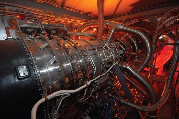

Shaw completed site and technology recommendations in December 2007. The generation technology options were quickly narrowed to fast-acting natural gas–fired, simple cycle combustion turbines (CTs). The turbine selection process began in January 2008 and ended in July 2008 when an agreement was reached with Pratt & Whitney Power Systems (PWPS) for three Swiftpacs, based on the FT8 combustion turbine (Figure 2). In addition, Shaw was retained as the owner’s engineer for the project in the fall of 2008.
2. The race goes to the swift. A close-up of the Pratt & Whitney Power Systems FT8 combustion turbine inside the enclosure shows how the output shaft on the right connects with a double-ended generator. Another FT8 is attached to the other side of the generator. The entire package is a 50-MW Swiftpac. Courtesy: Pratt & Whitney Power Systems
