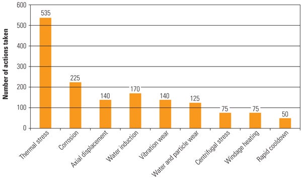

Cycling your plant without understanding the costs or applying care and expert guidance when cycling often leads to significant damage, frequent forced outages, and loss of power generation. Bad long-term decisions may be driven by short-term or uninformed decisions, making your plant unreliable during high-profit periods. The fatigue damage added to an older baseload power plant causes creep fatigue interaction damage, rapid increase in boiler tube failures, and many other component failures, including turbine generator and balance-of-plant early creep fatigue failures. In effect, excessive cycling will either decrease the life expectancy of your equipment, or the costs to maintain the equipment will rise, sometimes significantly. Also remember that poorly written startup and shutdown operating instructions or a failure to follow standard processes can often contribute to increased cycling damage and resultant costs.
In our experience, about 60% to 80% of all power plant failures are related to cycling operations. If plant management understands the costs and has a process that provides actual operating costs, it is able to take proactive operational measures rather than deal with unexpected costs and poor performance years after damage to plant systems is done (Figure 1).
1. Common problems in cycling plants. A survey of 215 steam plants found many common equipment problems. Source: Intertek-Aptech
