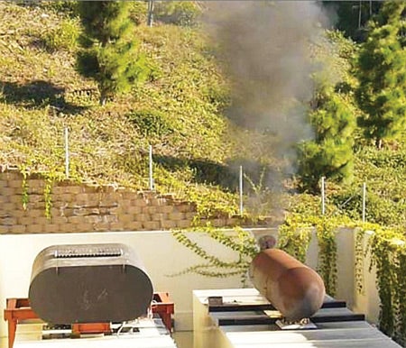

Quinn and EnerNOC agreed to install California Air Resources Board–approved diesel particulate filters (DPFs) that would reduce particulate matter emissions by over 85% (Figure 1). Another important benefit of the DPFs is that they significantly reduce carbon monoxide and hydrocarbon emissions. In addition, recent California regulations require the exclusive use of ultra-low-sulfur diesel fuel.
1. Nonsmokers only please. EnerNOC installs a California Air Resources Board–approved filter on each generator to reduce emissions. Both generators are running in this picture. The generator on the left shows post-installation air quality; the generator on the right shows pre-installation air quality. Courtesy: EnerNOC
