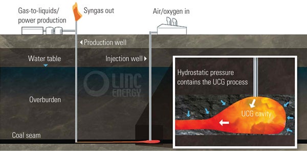

Essentially, the plant will use underground coal gasification (UCG) technology to convert coal buried deep underground into synthesis gas (or syngas) through the same chemical reactions that occur in conventional above-ground gasification plants (Figure 1). This typically requires constructing vertical wells to inject oxygen and water into a coal seam and discharging a mixture of production gases — such as carbon monoxide, hydrogen, methane, and carbon dioxide — to the surface.
1. Subsurface conversion. Underground coal gasification (UCG) technology is seeing a global revival. The basic process involves drilling two vertical boreholes into the coal, one for injection of the oxidants (water/air or water/oxygen mixtures) into the coal seam and another to draw the syngas out. The coal at the base of the first well is heated to temperatures that would normally cause it to burn. But through careful regulation of the oxidant flow, the coal instead separates into syngas. The process seems deceptively simple, but control of the gasification process has been at the heart of UCG development over many years. Courtesy: Linc Energy
